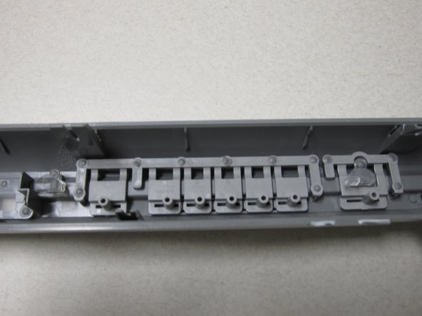

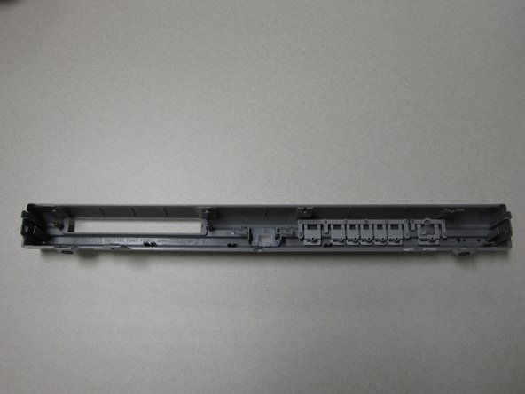

    1. Samsung P241 Front Panel Button replacement, Front Panel Buttons: crwdns2935265:07crwdnd2935265:01crwdnd2935265:02crwdne2935265:0 Samsung P241 Front Panel Button replacement, Front Panel Buttons: crwdns2935265:07crwdnd2935265:02crwdnd2935265:02crwdne2935265:0
      • Holding the front panel so the Samsung logo is visible, rotate the panel to view the opposite side.
    2. Samsung P241 Front Panel Button replacement: crwdns2935265:08crwdnd2935265:01crwdnd2935265:02crwdne2935265:0 Samsung P241 Front Panel Button replacement: crwdns2935265:08crwdnd2935265:02crwdnd2935265:02crwdne2935265:0
      • Locate the button panel on the inside towards what is now the right of the front panel.
    3. Samsung P241 Front Panel Button replacement: crwdns2935265:09crwdnd2935265:01crwdnd2935265:01crwdne2935265:0
      • To unjam a button, use a finger or flathead screwdriver, and firmly press against the jammed portion of the button panel.
      • Press until the button slides back into it's designated button slot.
    4. Samsung P241 Front Panel Button replacement: crwdns2935265:010crwdnd2935265:01crwdnd2935265:01crwdne2935265:0
      • If the button panel is broken, use a flathead screwdriver to pry the button panel from the back of the front panel.
      • With strong plastic adhesive, glue the new button panel into place with each button in it's designated button slot.
      • Allow the adhesive time to properly dry before pressing buttons.
    5. Samsung P241 Front Panel Button replacement: crwdns2935265:011crwdnd2935265:01crwdnd2935265:01crwdne2935265:0
      • If the button panel is not the cause of the problem, the button sensors on the motherboard need to be replaced.
      • You can refer to this guide for directions on how to solder new sensors on your motherboard if you don't want to replace the entire motherboard.
