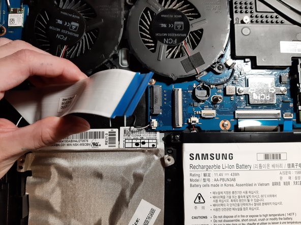

  5. Samsung Odyssey NP800G5M Speaker Replacement, Speaker: crwdns2935265:05crwdnd2935265:01crwdnd2935265:03crwdne2935265:0 Samsung Odyssey NP800G5M Speaker Replacement, Speaker: crwdns2935265:05crwdnd2935265:02crwdnd2935265:03crwdne2935265:0 Samsung Odyssey NP800G5M Speaker Replacement, Speaker: crwdns2935265:05crwdnd2935265:03crwdnd2935265:03crwdne2935265:0
    • Using the spudger, lift the black tab to release the ribbon cable.
    • Disconnect the USB ribbon cable.

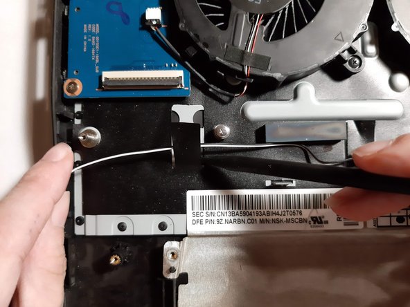

  6. Samsung Odyssey NP800G5M Speaker Replacement: crwdns2935265:06crwdnd2935265:01crwdnd2935265:02crwdne2935265:0 Samsung Odyssey NP800G5M Speaker Replacement: crwdns2935265:06crwdnd2935265:02crwdnd2935265:02crwdne2935265:0
    • Remove the tape securing the wire down.
    • This tape will remain sticky after removal.
  7. Samsung Odyssey NP800G5M Speaker Replacement: crwdns2935265:07crwdnd2935265:01crwdnd2935265:02crwdne2935265:0 Samsung Odyssey NP800G5M Speaker Replacement: crwdns2935265:07crwdnd2935265:02crwdnd2935265:02crwdne2935265:0
    • Disconnect the speakers by pulling the plugs out of their sockets.

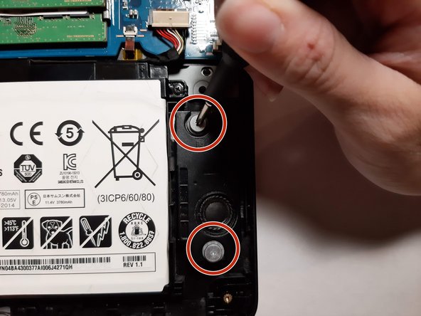

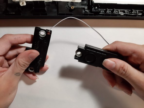

  8. Samsung Odyssey NP800G5M Speaker Replacement: crwdns2935265:08crwdnd2935265:01crwdnd2935265:03crwdne2935265:0 Samsung Odyssey NP800G5M Speaker Replacement: crwdns2935265:08crwdnd2935265:02crwdnd2935265:03crwdne2935265:0 Samsung Odyssey NP800G5M Speaker Replacement: crwdns2935265:08crwdnd2935265:03crwdnd2935265:03crwdne2935265:0
    • Using the Phillips #0 screwdriver, remove the four screws holding the speakers to device.
    • Remove the speakers from the device.
