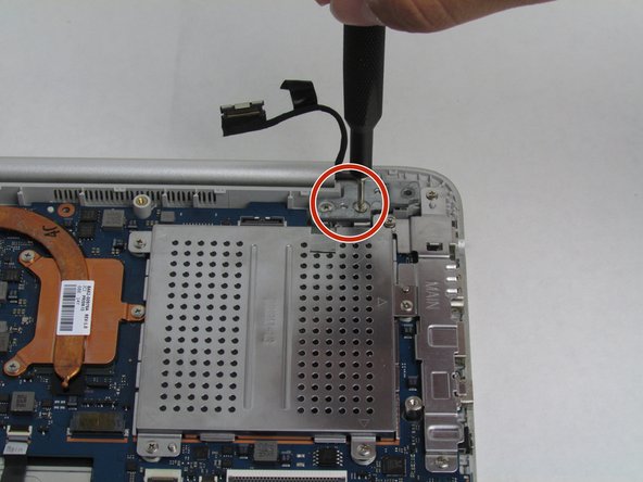

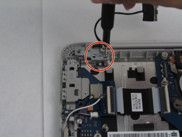

    • Remove the four 4.5mm screws using a Phillips #00 screwdriver that connect the top and bottom of the computer through the hinge.

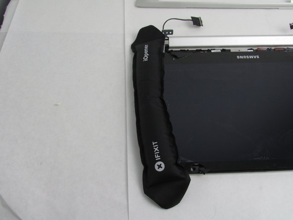

    • Heat the iFixit iOpener in the microwave for 30-45 seconds and apply it to the edges of the screen to loosen the adhesive.
    • iOpener will be HOT. Exercise caution.

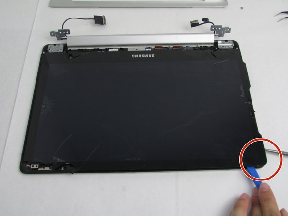

    • Once enough heat has been applied, use the plastic opening tool and the metal spudger to separate the screen from the backing.
    • Using the metal spudger may severely damage the internal components of your device. Using the metal spudger to remove any glass component is especiallydangerous and may cause harm to the device and the user.
    • The adhesive is thickest in the corners.

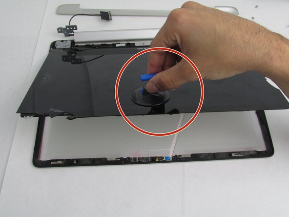

    • Use the suction cup to raise the screen backing with care. Do not remove the screen from the device yet as there are cables connected along the bottom.
