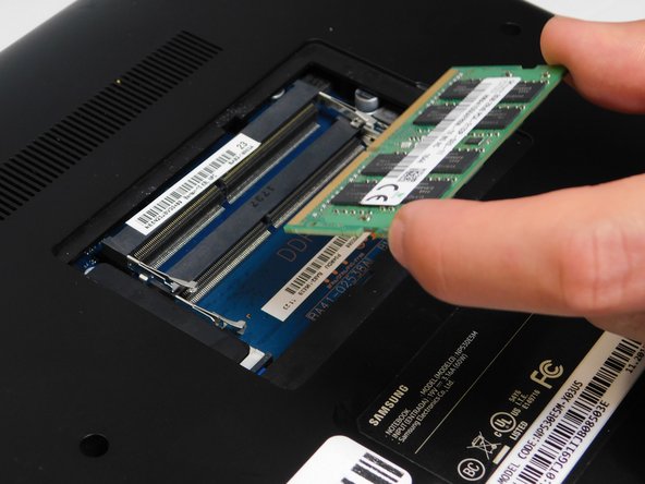

  5. Samsung Notebook 5 NP530E5M RAM Replacement: crwdns2935265:05crwdnd2935265:01crwdnd2935265:02crwdne2935265:0 Samsung Notebook 5 NP530E5M RAM Replacement: crwdns2935265:05crwdnd2935265:02crwdnd2935265:02crwdne2935265:0
    • Align the new unit with the RAM slot, and insert the RAM stick at a slight angle, it will rest loosely in its seat.
    • Lightly press down on the RAM until you hear a "snap". This means that the latches have clasped shut, securing the RAM stick.
    • There are two RAM slots in the Samsung Notebook 5 NP530E5M. We recommend that you install the first RAM in the bottom slot, in case you decide to add more RAM later, you wont need to worry about removing your first stick.
    • Replace the memory door and secure the screw. Tightening the screw, but be careful not to apply to much torque, "stripping" the screw, rendering it useless.
