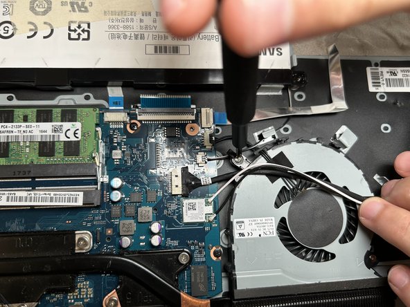

  7. Samsung Notebook 5 NP530E5M Fan Assembly Replacement, Fan Assembly: crwdns2935265:07crwdnd2935265:01crwdnd2935265:01crwdne2935265:0
    • Locate the fan assembly towards the top of the laptop.
    • The assembly includes the fan and the heat sink that is attached to the motherboard.
    • Using a spudger or iFixit opening tool, gently remove the cable from the motherboard.

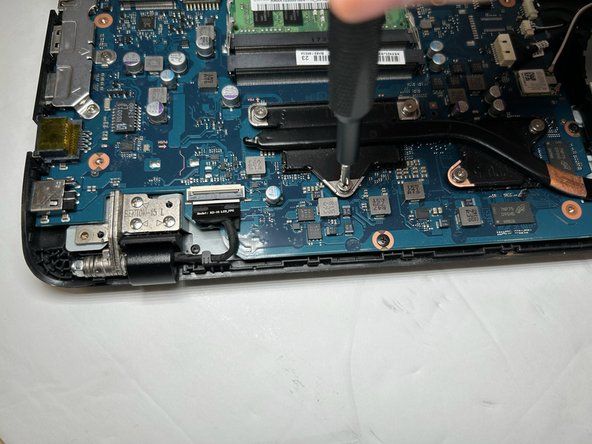

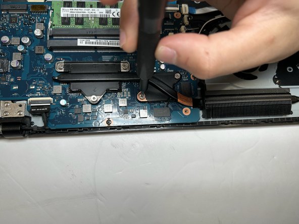

  8. Samsung Notebook 5 NP530E5M Fan Assembly Replacement: crwdns2935265:08crwdnd2935265:01crwdnd2935265:03crwdne2935265:0 Samsung Notebook 5 NP530E5M Fan Assembly Replacement: crwdns2935265:08crwdnd2935265:02crwdnd2935265:03crwdne2935265:0 Samsung Notebook 5 NP530E5M Fan Assembly Replacement: crwdns2935265:08crwdnd2935265:03crwdnd2935265:03crwdne2935265:0
    • Using your Phillips #000 screwdriver, unscrew the five screws mounting the heat sink to the motherboard.
    • These captive screws are attached to the heat sink itself, so they will not come out completely.

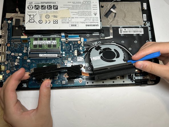

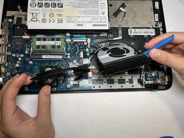

  10. Samsung Notebook 5 NP530E5M Fan Assembly Replacement: crwdns2935265:010crwdnd2935265:01crwdnd2935265:03crwdne2935265:0 Samsung Notebook 5 NP530E5M Fan Assembly Replacement: crwdns2935265:010crwdnd2935265:02crwdnd2935265:03crwdne2935265:0 Samsung Notebook 5 NP530E5M Fan Assembly Replacement: crwdns2935265:010crwdnd2935265:03crwdnd2935265:03crwdne2935265:0
    • Carefully unseat the fan assembly from the case, using the pry tool.
    • The heat sink portion should detach easily from the board.
