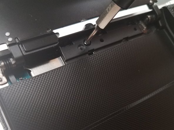

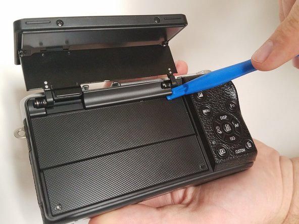

    1. Samsung NX500 Main board  Replacement, Screen Side Encasement: crwdns2935265:04crwdnd2935265:01crwdnd2935265:03crwdne2935265:0 Samsung NX500 Main board  Replacement, Screen Side Encasement: crwdns2935265:04crwdnd2935265:02crwdnd2935265:03crwdne2935265:0 Samsung NX500 Main board  Replacement, Screen Side Encasement: crwdns2935265:04crwdnd2935265:03crwdnd2935265:03crwdne2935265:0
      • Open the screen exposing the hinge cover and place the plastic opening tool inside.
      • Pry the hinge cover up by moving the plastic opening tool in a downward motion.
      • Remove the black 4mm Phillips #000 screw that is revealed once the hinge cover is removed.

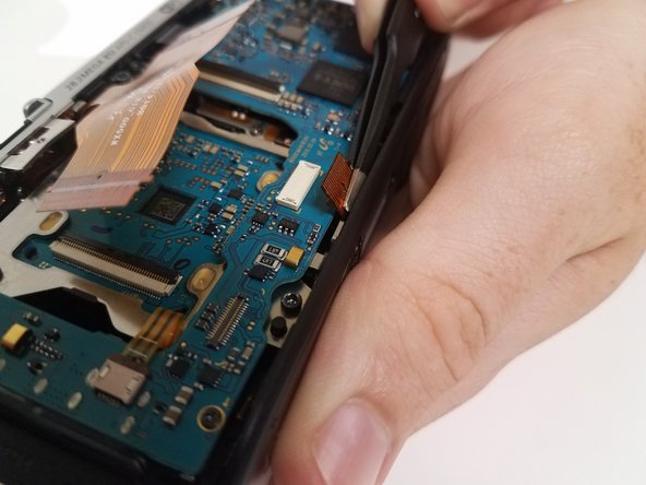

    3. Samsung NX500 Main board  Replacement: crwdns2935265:06crwdnd2935265:01crwdnd2935265:02crwdne2935265:0 Samsung NX500 Main board  Replacement: crwdns2935265:06crwdnd2935265:02crwdnd2935265:02crwdne2935265:0
      • Use the plastic opening tool in a downward motion around each side of the camera to pry the casing open.
      • The casing should be removed easily; you shouldn't have to use much force.
    4. Samsung NX500 Main board  Replacement: crwdns2935265:07crwdnd2935265:01crwdnd2935265:02crwdne2935265:0 Samsung NX500 Main board  Replacement: crwdns2935265:07crwdnd2935265:02crwdnd2935265:02crwdne2935265:0
      • Locate the black ribbon at the bottom left of the camera's interior.
      • Place the plastic opening tool under the black ribbon connector.
      • Remove the cable by moving your plastic opening tool in a downward motion.
      • There is zero to little force needed to remove this ribbon.
