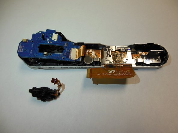

  8. Samsung NX300 Jog and Mode Dial Replacement, Remove the Jog Dial: crwdns2935265:08crwdnd2935265:01crwdnd2935265:03crwdne2935265:0 Samsung NX300 Jog and Mode Dial Replacement, Remove the Jog Dial: crwdns2935265:08crwdnd2935265:02crwdnd2935265:03crwdne2935265:0 Samsung NX300 Jog and Mode Dial Replacement, Remove the Jog Dial: crwdns2935265:08crwdnd2935265:03crwdnd2935265:03crwdne2935265:0
    • Using a Phillips #00 precision screwdriver, remove the 4mm screw holding the jog dial in place.
    • Using tweezers, gently remove the ribbon cable attached to the jog dial.

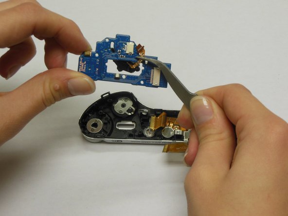

  9. Samsung NX300 Jog and Mode Dial Replacement, Remove the Connecting Ribon: crwdns2935265:09crwdnd2935265:01crwdnd2935265:03crwdne2935265:0 Samsung NX300 Jog and Mode Dial Replacement, Remove the Connecting Ribon: crwdns2935265:09crwdnd2935265:02crwdnd2935265:03crwdne2935265:0 Samsung NX300 Jog and Mode Dial Replacement, Remove the Connecting Ribon: crwdns2935265:09crwdnd2935265:03crwdnd2935265:03crwdne2935265:0
    • The jog dial should fall out easily. If not, use a pair of tweezers to gently poke it though the power board.
  10. Samsung NX300 Jog and Mode Dial Replacement, Remove the Buttons: crwdns2935265:010crwdnd2935265:01crwdnd2935265:02crwdne2935265:0 Samsung NX300 Jog and Mode Dial Replacement, Remove the Buttons: crwdns2935265:010crwdnd2935265:02crwdnd2935265:02crwdne2935265:0
    • Using a Phillips #00 precision screwdriver, remove the four 3mm screws holding the mode dial and power switch/shutter button in place.
    • Remove the metal mounts from the underside of the dials. The dials are now free from the camera.

Thanks, this was useful. Camera was switching modes randomly. I didn't replace the PCB however, just opened and sprayed a lot of silicon oil into the dial.
Marian Juranyi - crwdns2934203:0crwdne2934203:0
Thanks! I fixed my camera. But i think step 10 not necessary.
odiss2000 - crwdns2934203:0crwdne2934203:0
Perfect ! My Camera was switching modes randomly too. I changed the board from step 9 with a new part found on Ebay. Thank you :-)
sgexfabry - crwdns2934203:0crwdne2934203:0
