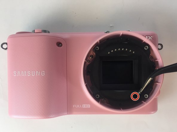

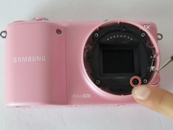

  3. Samsung NX2000 Lens Assembly Replacement: crwdns2935265:03crwdnd2935265:01crwdnd2935265:03crwdne2935265:0 Samsung NX2000 Lens Assembly Replacement: crwdns2935265:03crwdnd2935265:02crwdnd2935265:03crwdne2935265:0 Samsung NX2000 Lens Assembly Replacement: crwdns2935265:03crwdnd2935265:03crwdnd2935265:03crwdne2935265:0
    • Remove the four 4mm screws highlighted here with the Y0 screwdriver.
    • Using a tweezer, gently remove the outer silver lens lining.
    • Underneath will lie a black ring, which needs to removed using the same tweezer.
  4. Samsung NX2000 Lens Assembly Replacement: crwdns2935265:04crwdnd2935265:01crwdnd2935265:03crwdne2935265:0 Samsung NX2000 Lens Assembly Replacement: crwdns2935265:04crwdnd2935265:02crwdnd2935265:03crwdne2935265:0 Samsung NX2000 Lens Assembly Replacement: crwdns2935265:04crwdnd2935265:03crwdnd2935265:03crwdne2935265:0
    • Remove the final silver ring from the lens assembly using a tweezer.
    • Using a slanted tweezer, remove the highlighted pyramid screw from the compartment shown.
    • Remove the spring from the same compartment using the same tool.
