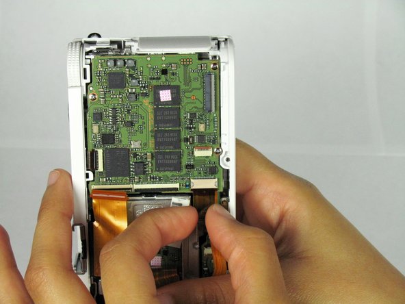

    • Using the plastic opening tool lift the motherboard up starting from the bottom left side.
  15. Samsung NX1000 Motherboard Replacement: crwdns2935265:015crwdnd2935265:01crwdnd2935265:01crwdne2935265:0
    • Pull out the board to the left, freeing the external ports from the plastic case.
    • Be careful when lifting the motherboard. There is one more ribbon cable to free before fully removing the board.
  16. Samsung NX1000 Motherboard Replacement: crwdns2935265:016crwdnd2935265:01crwdnd2935265:02crwdne2935265:0 Samsung NX1000 Motherboard Replacement: crwdns2935265:016crwdnd2935265:02crwdnd2935265:02crwdne2935265:0
    • Carefully place the motherboard back down to remove the last ribbon. Lift the black latch up from the ZIF connector of the last ribbon with the plastic opening tool.
  17. Samsung NX1000 Motherboard Replacement: crwdns2935265:017crwdnd2935265:01crwdnd2935265:01crwdne2935265:0
    • Slowly and carefully wiggle the ribbon out of the ZIF connection (Do this by holding the back of the ribbon).
