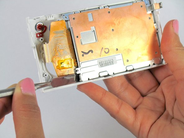

  9. Samsung NX1000 LCD Replacement: crwdns2935265:09crwdnd2935265:01crwdnd2935265:01crwdne2935265:0
    • Use the metal spudger to pick the bottom of the plastic piece while simultaneously using your index finger to push down on the larger metal slab. This will cause the metal plate with the large ribbon to slide down and out of the plastic back panel.
    • Do not disconnect the blue ribbon.
  10. Samsung NX1000 LCD Replacement, LCD: crwdns2935265:010crwdnd2935265:01crwdnd2935265:03crwdne2935265:0 Samsung NX1000 LCD Replacement, LCD: crwdns2935265:010crwdnd2935265:02crwdnd2935265:03crwdne2935265:0 Samsung NX1000 LCD Replacement, LCD: crwdns2935265:010crwdnd2935265:03crwdnd2935265:03crwdne2935265:0
    • Use a metal tool to pick on the sides of the metal plate to remove the plate from the plastic tabs.
  11. Samsung NX1000 LCD Replacement: crwdns2935265:011crwdnd2935265:01crwdnd2935265:02crwdne2935265:0 Samsung NX1000 LCD Replacement: crwdns2935265:011crwdnd2935265:02crwdnd2935265:02crwdne2935265:0
