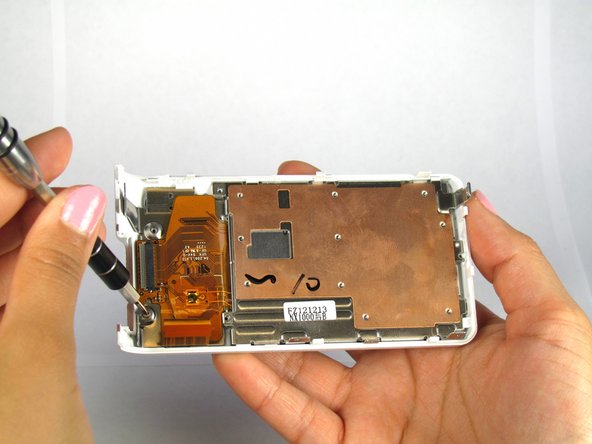

  7. Samsung NX1000 Back Panel Replacement, Back Panel Components: crwdns2935265:07crwdnd2935265:01crwdnd2935265:02crwdne2935265:0 Samsung NX1000 Back Panel Replacement, Back Panel Components: crwdns2935265:07crwdnd2935265:02crwdnd2935265:02crwdne2935265:0
    • Remove all five 3mm Philips #000 screws from the inside of the back panel using the Philips #000 Screwdriver.

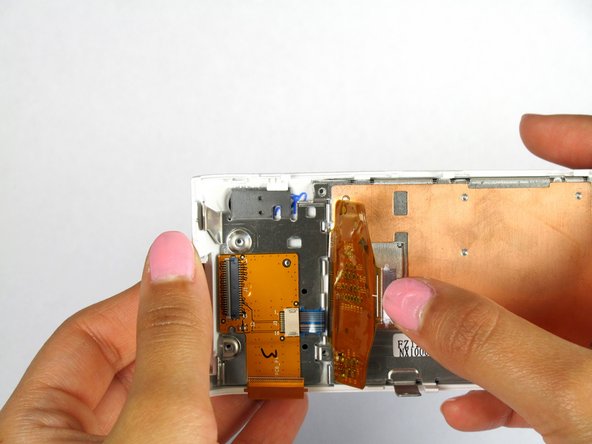

  8. Samsung NX1000 Back Panel Replacement: crwdns2935265:08crwdnd2935265:01crwdnd2935265:03crwdne2935265:0 Samsung NX1000 Back Panel Replacement: crwdns2935265:08crwdnd2935265:02crwdnd2935265:03crwdne2935265:0 Samsung NX1000 Back Panel Replacement: crwdns2935265:08crwdnd2935265:03crwdnd2935265:03crwdne2935265:0
    • Lift up the grey tab on the ZIF connector with the spudger to remove the ribbon.
    • Using both thumbs push the ribbon out of the ZIF connection.

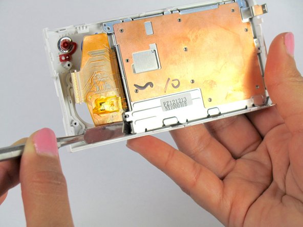

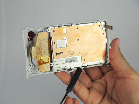

  9. Samsung NX1000 Back Panel Replacement: crwdns2935265:09crwdnd2935265:01crwdnd2935265:01crwdne2935265:0
    • Use the metal spudger to pick the bottom of the plastic piece while simultaneously using your index finger to push down on the larger metal slab. This will cause the metal plate with the large ribbon to slide down and out of the plastic back panel.
    • Do not disconnect the blue ribbon.

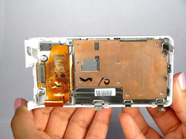

  10. Samsung NX1000 Back Panel Replacement, Back Panel: crwdns2935265:010crwdnd2935265:01crwdnd2935265:03crwdne2935265:0 Samsung NX1000 Back Panel Replacement, Back Panel: crwdns2935265:010crwdnd2935265:02crwdnd2935265:03crwdne2935265:0 Samsung NX1000 Back Panel Replacement, Back Panel: crwdns2935265:010crwdnd2935265:03crwdnd2935265:03crwdne2935265:0
    • Use a metal tool to pick on the sides of the metal plate to remove the plate from the plastic tabs.

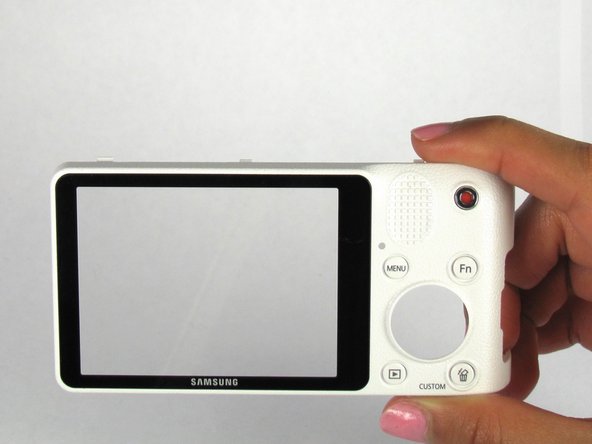

  11. Samsung NX1000 Back Panel Replacement: crwdns2935265:011crwdnd2935265:01crwdnd2935265:02crwdne2935265:0 Samsung NX1000 Back Panel Replacement: crwdns2935265:011crwdnd2935265:02crwdnd2935265:02crwdne2935265:0
    • Separate the back panel from the LCD.
