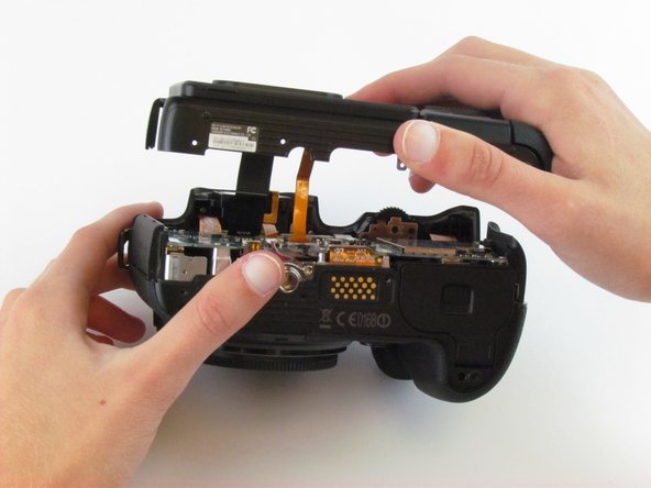

  7. Samsung NX1 Navigation Buttons Replacement: crwdns2935265:07crwdnd2935265:01crwdnd2935265:03crwdne2935265:0 Samsung NX1 Navigation Buttons Replacement: crwdns2935265:07crwdnd2935265:02crwdnd2935265:03crwdne2935265:0 Samsung NX1 Navigation Buttons Replacement: crwdns2935265:07crwdnd2935265:03crwdnd2935265:03crwdne2935265:0
    • Use a plastic opening tool to separate the back cover from the front cover.
    • Pry the back cover in this order: bottom, right side, left side.
  8. Samsung NX1 Navigation Buttons Replacement: crwdns2935265:08crwdnd2935265:01crwdnd2935265:02crwdne2935265:0 Samsung NX1 Navigation Buttons Replacement: crwdns2935265:08crwdnd2935265:02crwdnd2935265:02crwdne2935265:0
    • Use your fingers to pull the back cover away from the front cover.
    • Do not completely separate the back cover from the front cover as two cables hold these components together.
  9. Samsung NX1 Navigation Buttons Replacement: crwdns2935265:09crwdnd2935265:01crwdnd2935265:03crwdne2935265:0 Samsung NX1 Navigation Buttons Replacement: crwdns2935265:09crwdnd2935265:02crwdnd2935265:03crwdne2935265:0 Samsung NX1 Navigation Buttons Replacement: crwdns2935265:09crwdnd2935265:03crwdnd2935265:03crwdne2935265:0
    • Use tweezers to pull the two ribbon cables horizontally out of their clips.
