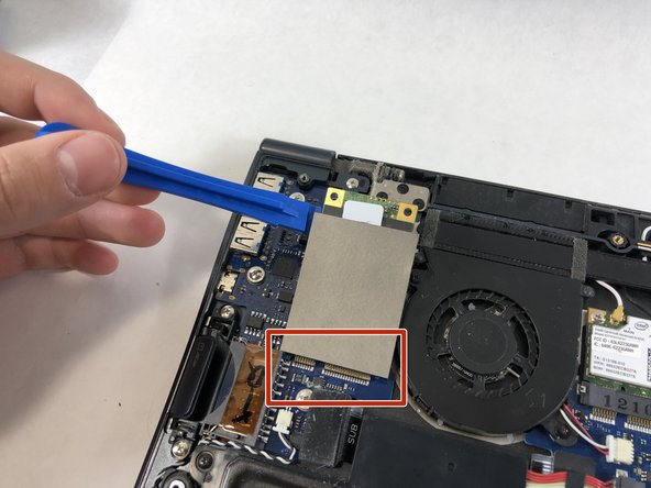

    • Before begining you must remove the back panel of the laptop. The Battery Removal guide demonstrates how to do this. The link to this guide is posed here. Samsung NP900X4B Battery Replacement
    • Once this is completed, use this image to locate the Hard Drive. It can be found in the upper left hand corner of the device.
  2. Samsung NP900X4B SSD Hard Drive Replacement: crwdns2935265:02crwdnd2935265:01crwdnd2935265:02crwdne2935265:0 Samsung NP900X4B SSD Hard Drive Replacement: crwdns2935265:02crwdnd2935265:02crwdnd2935265:02crwdne2935265:0
    • Remove the two 2.5mm Phillips #000 screws at the top of the SSD.
  3. Samsung NP900X4B SSD Hard Drive Replacement: crwdns2935265:03crwdnd2935265:01crwdnd2935265:02crwdne2935265:0 Samsung NP900X4B SSD Hard Drive Replacement: crwdns2935265:03crwdnd2935265:02crwdnd2935265:02crwdne2935265:0
    • Gently lift up from the top of the SSD card using a plastic opening tool.
    • Pull gently away from the drive slot located at the base of the SSD.
    • After removing the SSD memory chip, carefully insert the new SSD into the old slot. When completed, reinsert the two screws. Then, slowly remove the heat tape from the old SSD and apply to the new SSD.
