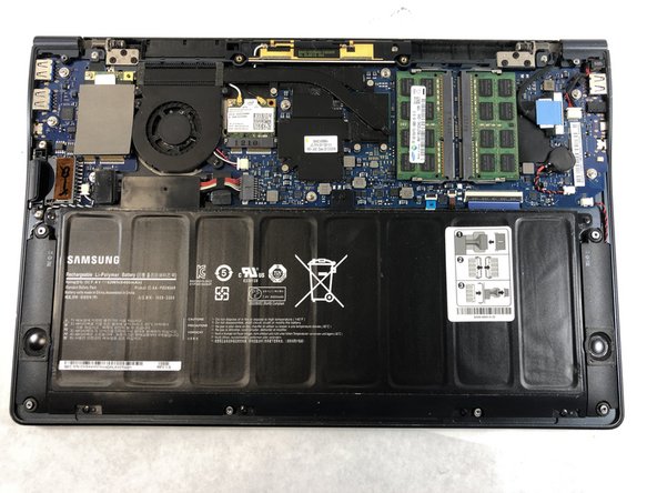

  4. Samsung NP900X4B Fan Replacement, Fan: crwdns2935265:04crwdnd2935265:01crwdnd2935265:02crwdne2935265:0 Samsung NP900X4B Fan Replacement, Fan: crwdns2935265:04crwdnd2935265:02crwdnd2935265:02crwdne2935265:0
    • Next locate the two Phillips #0 2.5mm screws on both the top right and bottom left corner of the fan.
  5. Samsung NP900X4B Fan Replacement: crwdns2935265:05crwdnd2935265:01crwdnd2935265:01crwdne2935265:0
    • After locating the screws, using the Phillips #0 screwdriver, remove the screws from the fan.
  6. Samsung NP900X4B Fan Replacement: crwdns2935265:06crwdnd2935265:01crwdnd2935265:02crwdne2935265:0 Samsung NP900X4B Fan Replacement: crwdns2935265:06crwdnd2935265:02crwdnd2935265:02crwdne2935265:0
    • Use the plastic opening tool to remove the cable connector from its housing which is just to the right of the fan.
  7. Samsung NP900X4B Fan Replacement: crwdns2935265:07crwdnd2935265:01crwdnd2935265:01crwdne2935265:0
    • Once the cable has been removed from its housing you are free to remove the fan from the laptop.
    • You can either clean the fan with a computer duster or other cleaner, or replace it with a new one.
