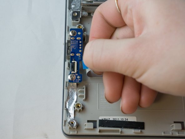

  7. Samsung NP700Z5AH Optical Drive Replacement, Optical Drive: crwdns2935265:07crwdnd2935265:01crwdnd2935265:02crwdne2935265:0 Samsung NP700Z5AH Optical Drive Replacement, Optical Drive: crwdns2935265:07crwdnd2935265:02crwdnd2935265:02crwdne2935265:0
    • Using your fingers, grasp the ribbon cable connected to the optical drive and pull it straight out to disconnect it.
    • To reinstall the cable, hold it near the end and push it straight into the connector, being careful not to kink the cable.

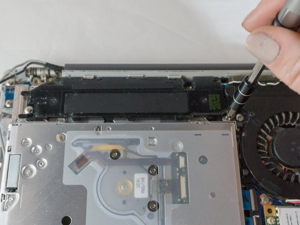

  8. Samsung NP700Z5AH Optical Drive Replacement: crwdns2935265:08crwdnd2935265:01crwdnd2935265:02crwdne2935265:0 Samsung NP700Z5AH Optical Drive Replacement: crwdns2935265:08crwdnd2935265:02crwdnd2935265:02crwdne2935265:0
    • Using the Phillips#00 remove the three 3.5mm screws that secure the speaker to the bottom case.

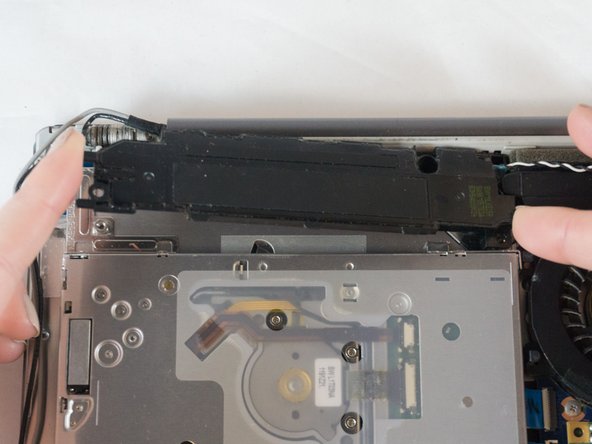

  9. Samsung NP700Z5AH Optical Drive Replacement: crwdns2935265:09crwdnd2935265:01crwdnd2935265:02crwdne2935265:0 Samsung NP700Z5AH Optical Drive Replacement: crwdns2935265:09crwdnd2935265:02crwdnd2935265:02crwdne2935265:0
    • With your fingers, grasp the edges of the speaker and slide it up and away from the fan to lift it out of the case.

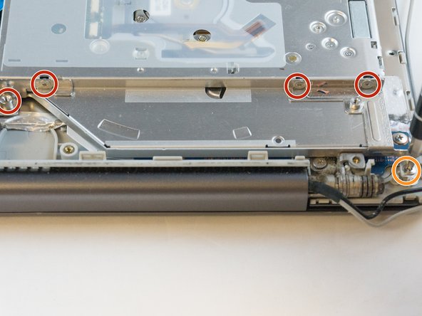

  10. Samsung NP700Z5AH Optical Drive Replacement: crwdns2935265:010crwdnd2935265:01crwdnd2935265:03crwdne2935265:0 Samsung NP700Z5AH Optical Drive Replacement: crwdns2935265:010crwdnd2935265:02crwdnd2935265:03crwdne2935265:0 Samsung NP700Z5AH Optical Drive Replacement: crwdns2935265:010crwdnd2935265:03crwdnd2935265:03crwdne2935265:0
    • With the Phillips#00, remove the following screws holding the optical drive to the metal brackets.
    • Six 2.4mm screws
    • One 3.4mm screw
    • Using your fingers, grasp the metal brackets and remove them.
