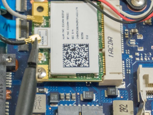

      • Place the tip of the spudger under the metal caps of the black and grey coaxial connectors and pry upwards to disconnect them.
      • After they are disconnected, un-thread the coaxial connectors from around the fan.
      • To reinstall, hold the connectors in place and gently press them straight down. The connectors "snap" into their sockets much like the metal snaps on a jacket.

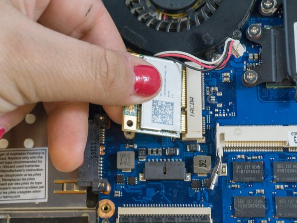

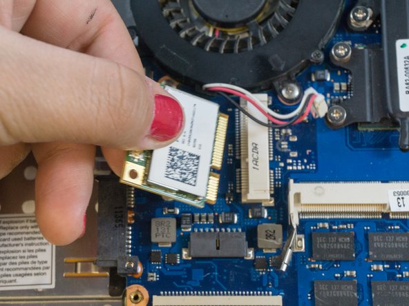

      • Using the Phillips#00, remove the single 3.5mm screw from the wireless card.
      • Grasp the edges of the wireless card with your fingers and pull straight backwards to remove it.

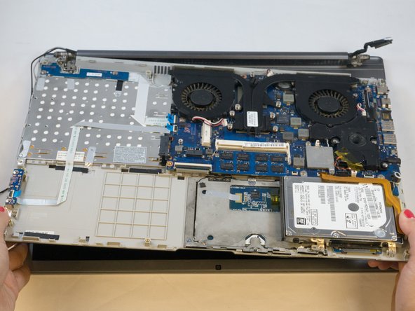

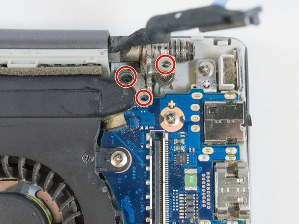

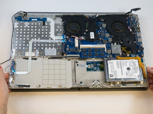

      • Using the Phillips#00, remove the six 4.5mm screws from the corner brackets holding the display to the inner case.
    4. Samsung NP700Z5AH Display Replacement: crwdns2935265:010crwdnd2935265:01crwdnd2935265:03crwdne2935265:0 Samsung NP700Z5AH Display Replacement: crwdns2935265:010crwdnd2935265:02crwdnd2935265:03crwdne2935265:0 Samsung NP700Z5AH Display Replacement: crwdns2935265:010crwdnd2935265:03crwdnd2935265:03crwdne2935265:0
      • Using your fingers, grasp the edges of the inner case then lift and pull away to separate it from the display.
