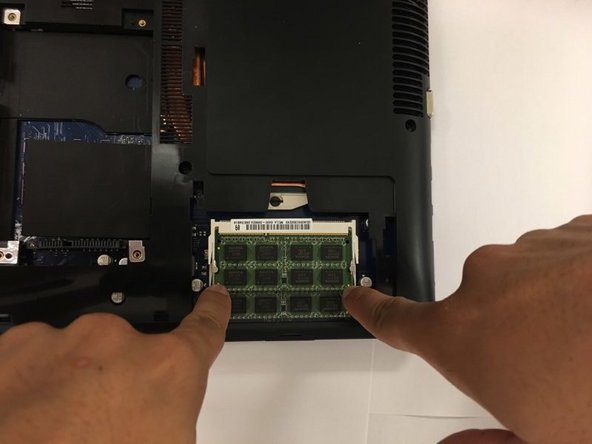

    • Unscrew the screws that are holding the cover in place.
    • Slide open the cover of your RAM.
    • Remember to place screws in a safe location.
  2. Samsung NP550P5C-T01US RAM replacement: crwdns2935265:02crwdnd2935265:01crwdnd2935265:03crwdne2935265:0 Samsung NP550P5C-T01US RAM replacement: crwdns2935265:02crwdnd2935265:02crwdnd2935265:03crwdne2935265:0 Samsung NP550P5C-T01US RAM replacement: crwdns2935265:02crwdnd2935265:03crwdnd2935265:03crwdne2935265:0
    • Remove your RAM pushing the clips on the sides inward and pull it out
    • remember to not touch the golden contacts
  3. Samsung NP550P5C-T01US RAM replacement: crwdns2935265:03crwdnd2935265:01crwdnd2935265:02crwdne2935265:0 Samsung NP550P5C-T01US RAM replacement: crwdns2935265:03crwdnd2935265:02crwdnd2935265:02crwdne2935265:0
    • Slide in the correct RAM type
    • Push the RAM by the sides downward until you hear a click
    • re-do all of these steps in reverse order from step 2-1
