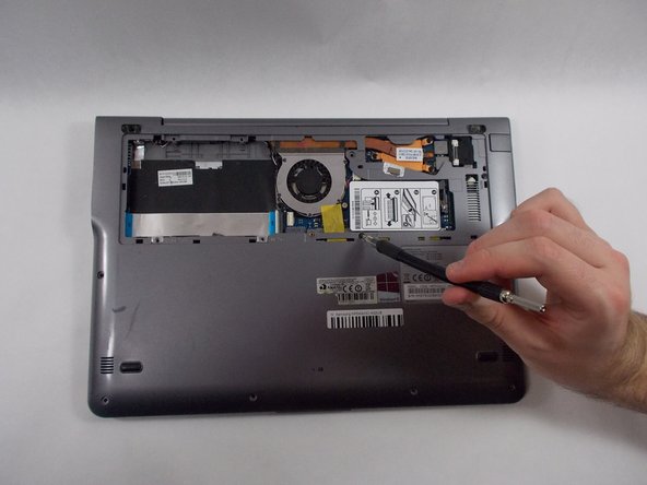

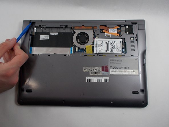

  10. Samsung NP540U3C-A02UB RAM Replacement: crwdns2935265:010crwdnd2935265:01crwdnd2935265:01crwdne2935265:0
    • Using the plastic opening tool, gently lift and remove the back cover.
    • There are clips along the edges of the back cover that hold it in place. Be careful not to break these.

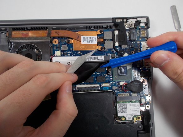

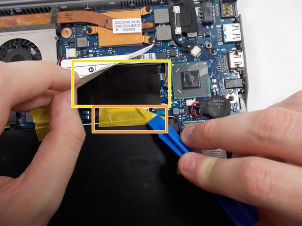

  11. Samsung NP540U3C-A02UB RAM Replacement: crwdns2935265:011crwdnd2935265:01crwdnd2935265:03crwdne2935265:0 Samsung NP540U3C-A02UB RAM Replacement: crwdns2935265:011crwdnd2935265:02crwdnd2935265:03crwdne2935265:0 Samsung NP540U3C-A02UB RAM Replacement: crwdns2935265:011crwdnd2935265:03crwdnd2935265:03crwdne2935265:0
    • Lift up the white instruction guide with your hand to expose the RAM module underneath.
    • Using the plastic opening tool or your hand, peel off the yellow tape.
    • Using the plastic opening tool or your hand, gently remove the black cover that lays on top of the RAM.
  12. Samsung NP540U3C-A02UB RAM Replacement: crwdns2935265:012crwdnd2935265:01crwdnd2935265:01crwdne2935265:0
    • Additional RAM can be added or removed on top of the 4 GB RAM that comes with the laptop.
    • The new RAM chip slides on top in-between the brackets.
    • The 4 GB RAM that initially comes with the laptop can not be removed.
