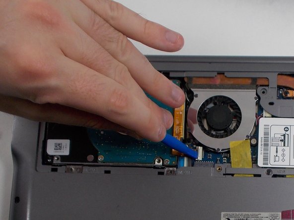

    • Remove the four 6 mm Phillips #00 screws attaching the hard drive to the case.
  5. Samsung NP540U3C-A02UB Hinge Replacement: crwdns2935265:05crwdnd2935265:01crwdnd2935265:02crwdne2935265:0 Samsung NP540U3C-A02UB Hinge Replacement: crwdns2935265:05crwdnd2935265:02crwdnd2935265:02crwdne2935265:0
    • Using the plastic opening tool, push the hard drive connector clip upwards in order to release the cable.
  6. Samsung NP540U3C-A02UB Hinge Replacement: crwdns2935265:06crwdnd2935265:01crwdnd2935265:02crwdne2935265:0 Samsung NP540U3C-A02UB Hinge Replacement: crwdns2935265:06crwdnd2935265:02crwdnd2935265:02crwdne2935265:0
    • Remove the hard drive from the case.

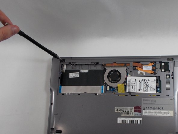

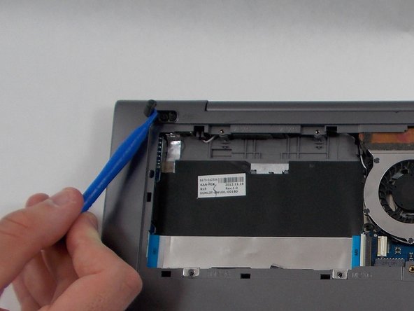

  8. Samsung NP540U3C-A02UB Hinge Replacement: crwdns2935265:08crwdnd2935265:01crwdnd2935265:02crwdne2935265:0 Samsung NP540U3C-A02UB Hinge Replacement: crwdns2935265:08crwdnd2935265:02crwdnd2935265:02crwdne2935265:0
    • Using the opening tool, remove the two rubber pads just above the hard drive cover.
  9. Samsung NP540U3C-A02UB Hinge Replacement: crwdns2935265:09crwdnd2935265:01crwdnd2935265:02crwdne2935265:0 Samsung NP540U3C-A02UB Hinge Replacement: crwdns2935265:09crwdnd2935265:02crwdnd2935265:02crwdne2935265:0
    • Remove the two 4 mm Phillips #00 screws formerly concealed by the pads.

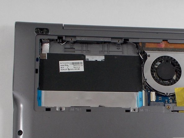

  10. Samsung NP540U3C-A02UB Hinge Replacement: crwdns2935265:010crwdnd2935265:01crwdnd2935265:01crwdne2935265:0
    • Using the plastic opening tool, gently lift and remove the back cover.
    • There are clips along the edges of the back cover that hold it in place. Be careful not to break these.
