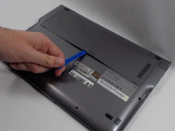

    • Remove the 1x 4mm Phillips #00 screw labeled "HDD Memory".
  3. Samsung NP540U3C-A02UB Fan Replacement: crwdns2935265:03crwdnd2935265:01crwdnd2935265:03crwdne2935265:0 Samsung NP540U3C-A02UB Fan Replacement: crwdns2935265:03crwdnd2935265:02crwdnd2935265:03crwdne2935265:0 Samsung NP540U3C-A02UB Fan Replacement: crwdns2935265:03crwdnd2935265:03crwdnd2935265:03crwdne2935265:0

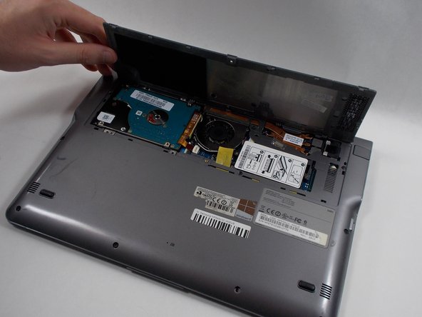

    • Gently release the three clips holding the HDD cover with the plastic opening tool.
    • Remove the HDD cover from the device.

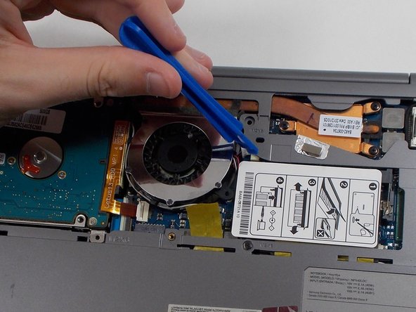

  6. Samsung NP540U3C-A02UB Fan Replacement: crwdns2935265:06crwdnd2935265:01crwdnd2935265:02crwdne2935265:0 Samsung NP540U3C-A02UB Fan Replacement: crwdns2935265:06crwdnd2935265:02crwdnd2935265:02crwdne2935265:0
    • Using the plastic opening tool, gently disconnect the fan from the motherboard by unplugging the wire.
  7. Samsung NP540U3C-A02UB Fan Replacement: crwdns2935265:07crwdnd2935265:01crwdnd2935265:01crwdne2935265:0
    • Remove the fan from the case.
