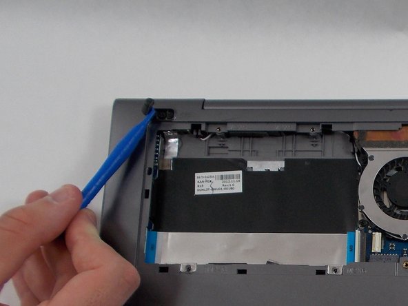

    • Using the opening tool, remove the two rubber pads just above the hard drive cover.

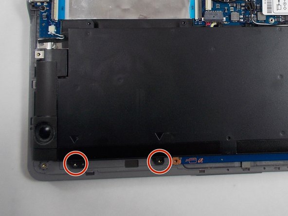

  9. Samsung NP540U3C-A02UB Battery Replacement: crwdns2935265:09crwdnd2935265:01crwdnd2935265:02crwdne2935265:0 Samsung NP540U3C-A02UB Battery Replacement: crwdns2935265:09crwdnd2935265:02crwdnd2935265:02crwdne2935265:0
    • Remove the 2x 4mm Phillips #00 screws formerly concealed by the pads.

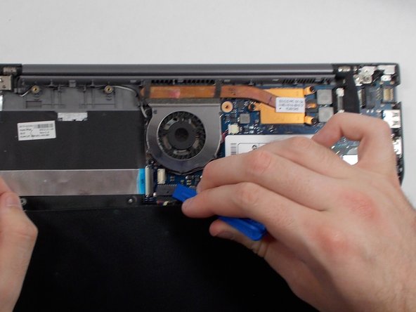

  11. Samsung NP540U3C-A02UB Battery Replacement: crwdns2935265:011crwdnd2935265:01crwdnd2935265:02crwdne2935265:0 Samsung NP540U3C-A02UB Battery Replacement: crwdns2935265:011crwdnd2935265:02crwdnd2935265:02crwdne2935265:0
    • Using your hands or the plastic opening tool, gently remove the tape holding the wires in place.
