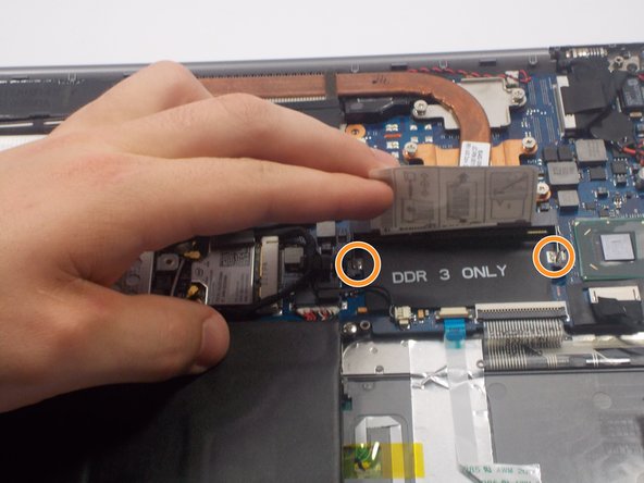

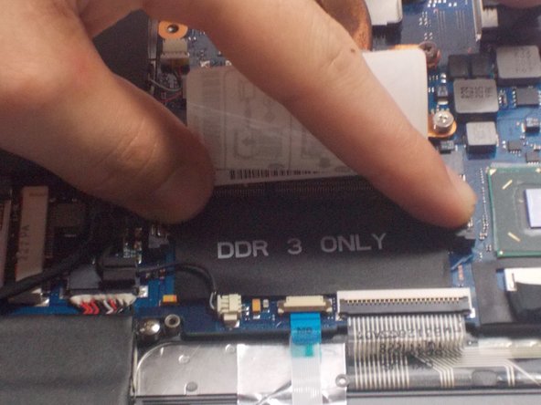

    • All steps following the removal of the back cover should be completed while wearing an Anti static bracelet. This prevents ESD (electrostatic discharge). ESD can damage nearly every part on the inside of your computer.
  7. Samsung NP530U4BL RAM Replacement, RAM: crwdns2935265:07crwdnd2935265:01crwdnd2935265:03crwdne2935265:0 Samsung NP530U4BL RAM Replacement, RAM: crwdns2935265:07crwdnd2935265:02crwdnd2935265:03crwdne2935265:0 Samsung NP530U4BL RAM Replacement, RAM: crwdns2935265:07crwdnd2935265:03crwdnd2935265:03crwdne2935265:0
    • When working on the inside of the laptop, it is very easy to damage small pins and other parts of the machine. Keep your hands on the edges of the laptop unless instructed otherwise.
    • The RAM is kept in place by two silver tabs. To disengage these tabs, push them outwards at the same time, releasing the lock on the RAM.
    • RAM (the actual RAM is not pictured)
    • Using your dominant hand's index finger and thumb, squeeze the RAM gently on the two sides that were not held down by the pins and lift it horizontally from the base.

Why this site is telling people to remove the whole of the back panel is beyond me. By removing the hard drive cover the ram slot is easily accessible. You only need to remove one screw to access it instead of the 10 recommended by this expert. If you are looking into upgrading your ram please remove the hard drive cover and just have a look at what is right there. Don’t need to be Bill Gates to see that it’s designed to be able to get to the ram slot from there. Good luck.
