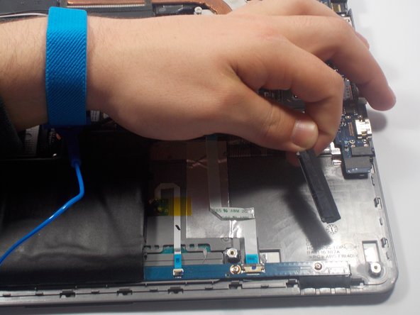

    • All steps following the removal of the back cover should be completed while wearing an Anti static bracelet. This prevents ESD (electrostatic discharge). ESD can damage nearly every part on the inside of your computer.
  7. Samsung NP530U4BL Hard Drive Replacement, Hard Drive: crwdns2935265:07crwdnd2935265:01crwdnd2935265:02crwdne2935265:0 Samsung NP530U4BL Hard Drive Replacement, Hard Drive: crwdns2935265:07crwdnd2935265:02crwdnd2935265:02crwdne2935265:0
    • Hard Drive (not pictured)
    • Using your dominant hand, unplug the hard drive from its SATA plug. Once unplugged, the hard drive is an independent piece from the laptop.
  8. Samsung NP530U4BL Hard Drive Replacement: crwdns2935265:08crwdnd2935265:01crwdnd2935265:01crwdne2935265:0
    • When handling the hard drive, do so carefully. Dropping or banging the hard drive can risk serious damage to the part.
    • Carefully lift the hard drive vertically out of its place.
