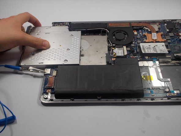

  6. Samsung NP530U4BL CD Drive Replacement: crwdns2935265:06crwdnd2935265:01crwdnd2935265:02crwdne2935265:0 Samsung NP530U4BL CD Drive Replacement: crwdns2935265:06crwdnd2935265:02crwdnd2935265:02crwdne2935265:0
    • All steps following the removal of the back cover should be completed while wearing an Anti static bracelet. This prevents ESD (electrostatic discharge). ESD can damage nearly every part on the inside of your computer.
  7. Samsung NP530U4BL CD Drive Replacement, CD Drive: crwdns2935265:07crwdnd2935265:01crwdnd2935265:02crwdne2935265:0 Samsung NP530U4BL CD Drive Replacement, CD Drive: crwdns2935265:07crwdnd2935265:02crwdnd2935265:02crwdne2935265:0
    • Press down on the drive with your left thumb and slowly slide it out of place. The drive should slide all the way out of the machine until it is detahced.
    • Be sure to slide the CD Drive, do not lift it. Lifting the CD drive could damage small pins and other sensitive parts near the CD drive.
