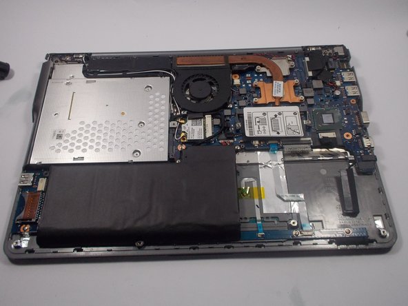

  5. Samsung NP530U4BL Battery Replacement: crwdns2935265:05crwdnd2935265:01crwdnd2935265:02crwdne2935265:0 Samsung NP530U4BL Battery Replacement: crwdns2935265:05crwdnd2935265:02crwdnd2935265:02crwdne2935265:0
    • Using your dominant hand, grasp the left side of the back cover and gently pull it up. This should disengage the prongs on the bottom and right edge of the base.
    • The right side of the cover has openings that go around the USB ports, the HDMI port, the Ethernet port, the VGA port, and the headphone jack. Use caution when disengaging the prongs around these parts.
    • After completing this step the entire back cover should be separated from the base, and the inside of the laptop should be revealed.

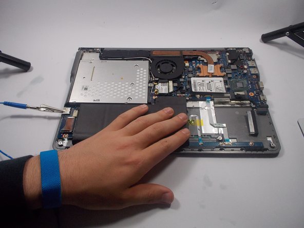

  6. Samsung NP530U4BL Battery Replacement: crwdns2935265:06crwdnd2935265:01crwdnd2935265:02crwdne2935265:0 Samsung NP530U4BL Battery Replacement: crwdns2935265:06crwdnd2935265:02crwdnd2935265:02crwdne2935265:0
    • All steps following the removal of the back cover should be completed while wearing an Anti static bracelet. This prevents ESD (electrostatic discharge). ESD can damage nearly every part on the inside of your computer.

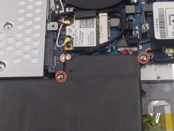

  7. Samsung NP530U4BL Battery Replacement, Battery: crwdns2935265:07crwdnd2935265:01crwdnd2935265:02crwdne2935265:0 Samsung NP530U4BL Battery Replacement, Battery: crwdns2935265:07crwdnd2935265:02crwdnd2935265:02crwdne2935265:0
    • On each side of the portion that is jutting out, there is one, silver 1.5 mm screw. Using the Phillips #00 screwdriver, remove these two screws.

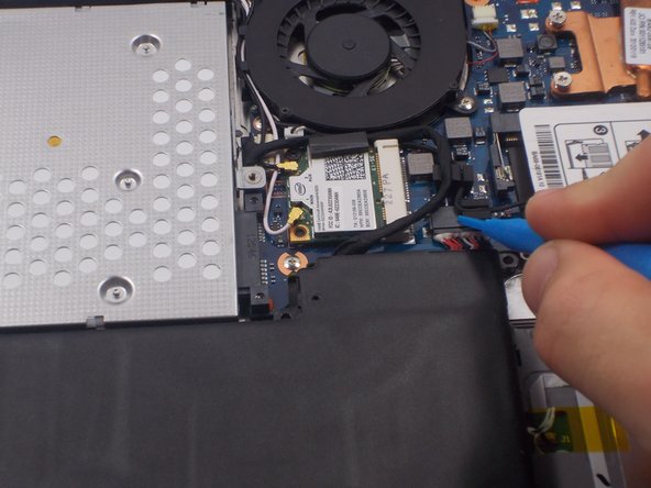

  8. Samsung NP530U4BL Battery Replacement: crwdns2935265:08crwdnd2935265:01crwdnd2935265:02crwdne2935265:0 Samsung NP530U4BL Battery Replacement: crwdns2935265:08crwdnd2935265:02crwdnd2935265:02crwdne2935265:0
    • Using the plastic opening tool, carefully separate the battery from the plug that connects the battery to the circuit board.
    • Use caution when removing the battery from the plug. Damaging any of the wires attached to the plug could affect the battery's functionality.
  9. Samsung NP530U4BL Battery Replacement: crwdns2935265:09crwdnd2935265:01crwdnd2935265:01crwdne2935265:0
    • Using your dominant hand, carefully lift the battery vertically out of place, making sure to handle with care and to not bump any other parts of the computer.
