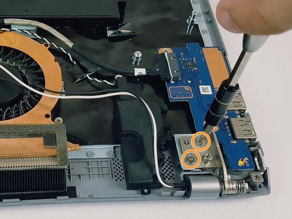

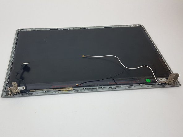

  7. Samsung NP510R5E-A01UB Display Replacement: crwdns2935265:07crwdnd2935265:01crwdnd2935265:03crwdne2935265:0 Samsung NP510R5E-A01UB Display Replacement: crwdns2935265:07crwdnd2935265:02crwdnd2935265:03crwdne2935265:0 Samsung NP510R5E-A01UB Display Replacement: crwdns2935265:07crwdnd2935265:03crwdnd2935265:03crwdne2935265:0
    • Unscrew the two 4.45mm long screws to disconnect the left hinge.
    • Unscrew the two 4.45mm long screws to disconnect the right hinge.
    • At this point the screen and plastic housing should be completely disconnected.

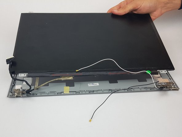

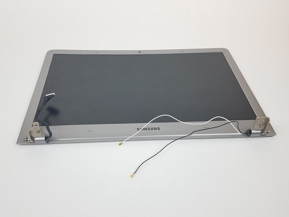

  8. Samsung NP510R5E-A01UB Display Replacement: crwdns2935265:08crwdnd2935265:01crwdnd2935265:02crwdne2935265:0 Samsung NP510R5E-A01UB Display Replacement: crwdns2935265:08crwdnd2935265:02crwdnd2935265:02crwdne2935265:0
    • Using the plastic opening tool, pry open the plastic housing that holds the display.

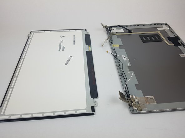

  9. Samsung NP510R5E-A01UB Display Replacement: crwdns2935265:09crwdnd2935265:01crwdnd2935265:02crwdne2935265:0 Samsung NP510R5E-A01UB Display Replacement: crwdns2935265:09crwdnd2935265:02crwdnd2935265:02crwdne2935265:0
    • Unscrew the four 3.55mm long screws that hold the display in place.
  10. Samsung NP510R5E-A01UB Display Replacement: crwdns2935265:010crwdnd2935265:01crwdnd2935265:02crwdne2935265:0 Samsung NP510R5E-A01UB Display Replacement: crwdns2935265:010crwdnd2935265:02crwdnd2935265:02crwdne2935265:0
    • Disconnect the last cable by pulling straight out.
