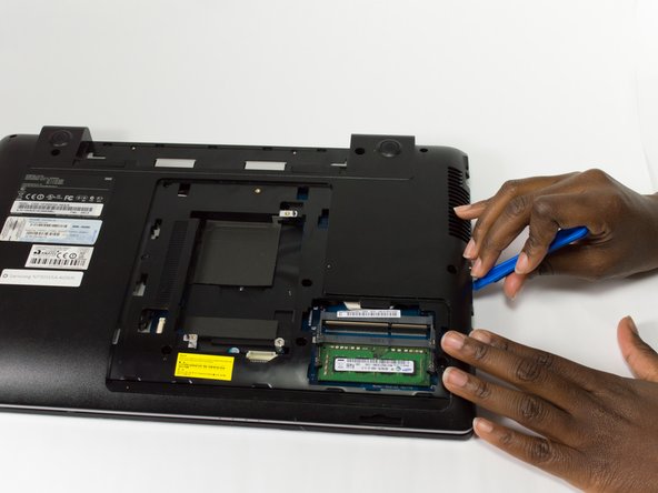

    • Unscrew the 3.5mm screws using a Phillips J0 Screwdriver by rotating the screwdriver in the counter clockwise direction.
  2. Samsung NP305E5A-A03US Optical Drive Replacement: crwdns2935265:02crwdnd2935265:01crwdnd2935265:01crwdne2935265:0
    • Wedge the plastic opening tool between the L-shaped back panel to slide the panel off.
    • Note this may take force. If you have difficulties using the plastic opening tool, try to use your hands to pull the panel off.

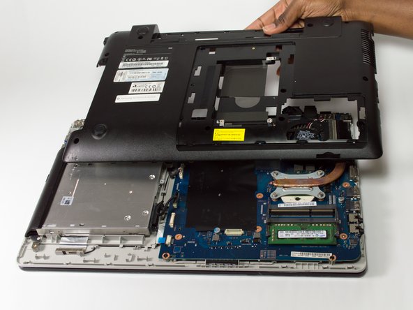

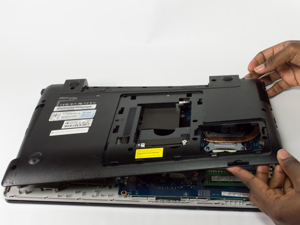

  8. Samsung NP305E5A-A03US Optical Drive Replacement: crwdns2935265:08crwdnd2935265:01crwdnd2935265:02crwdne2935265:0 Samsung NP305E5A-A03US Optical Drive Replacement: crwdns2935265:08crwdnd2935265:02crwdnd2935265:02crwdne2935265:0
    • Insert the plastic opening tool between the seam of the back panel and the laptop.
    • Slide the plastic opening tool along the seam to loosen the back panel from the laptop.
    • It may be difficult to slide the plastic opening tool along the seam, so you may have to apply some force.
  9. Samsung NP305E5A-A03US Optical Drive Replacement: crwdns2935265:09crwdnd2935265:01crwdnd2935265:03crwdne2935265:0 Samsung NP305E5A-A03US Optical Drive Replacement: crwdns2935265:09crwdnd2935265:02crwdnd2935265:03crwdne2935265:0 Samsung NP305E5A-A03US Optical Drive Replacement: crwdns2935265:09crwdnd2935265:03crwdnd2935265:03crwdne2935265:0
    • Remove the Back Panel by lifting it towards you.
    • It may take some force to remove the Back Panel.

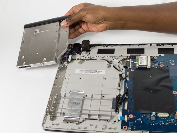

  10. Samsung NP305E5A-A03US Optical Drive Replacement: crwdns2935265:010crwdnd2935265:01crwdnd2935265:02crwdne2935265:0 Samsung NP305E5A-A03US Optical Drive Replacement: crwdns2935265:010crwdnd2935265:02crwdnd2935265:02crwdne2935265:0
    • Remove the Optical Drive by sliding it away from the laptop.
