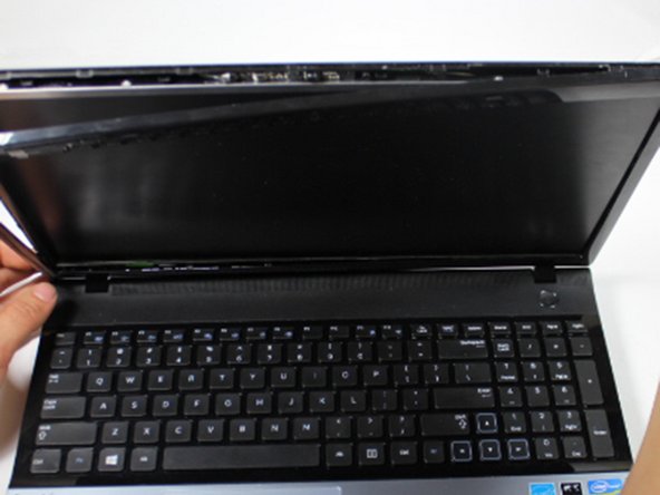

    • Insert the plastic opening tool into the seam on the top of the screen.
    • The seam is where the back screen cover and the plastic bezel around the edges of the screen meet.
    • Use the plastic opening tool to pop open the clasps that keep the casing on the screen.
    • It helps to use the plastic opening tool like a crowbar.
    • Follow this seam around the laptop's screen with the plastic opening tool until the plastic cover comes off.
    • Don't be afraid to use your fingers to help pop open the clips.

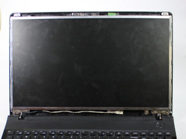

    • Using a Phillips #000 screwdriver, remove the top two 4 mm Phillips #8 screws that join the LCD screen to the plastic casing.
    • Using the same screwdriver, remove the bottom four 4 mm Phillips #8 screws that mount the screen onto the base of the laptop.
    • As you remove these bottom 4 screws, support the screen! As the screws come off, the screen will begin to fall backwards.

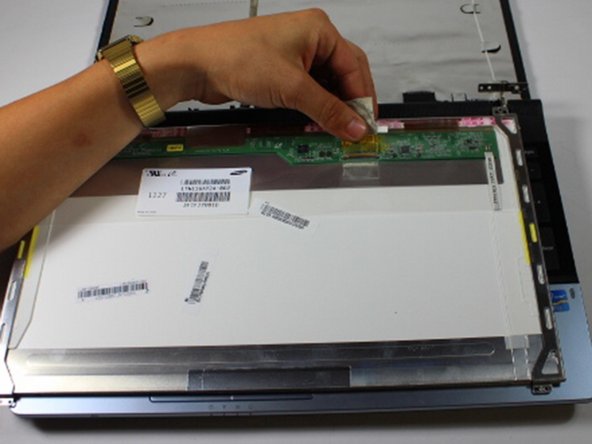

    • Gently lay the LCD on the keyboard, and lay down the back panel of the screen as well. They are not attached and will separate easily.
    • The LCD and the back panel must remain close to one another due to the video connector at the bottom that links the two.

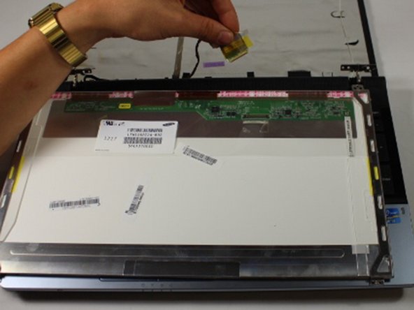

    • Remove the tape that secures the video connector to the LCD.
    • While maintaining a firm grip on the LCD, grasp the video connector at its base, and pull it away from you.
    • Don't be afraid to pull, the video connector is not soldered onto the LCD.
