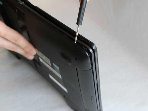

    • Remove the grip pad at the top right corner of the laptop using a Phillips screwdriver. Pop the grip pad from its place to reveal a 4 mm screw.
    • Remove all seventeen 4 mm screws.
    • Be careful not to tear the rubber foot hiding the screw.

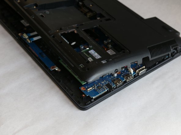

    • Use an opening tool to pop the back panel of the laptop off. Start at the corners and slide the opening tool along the edges of the laptop.
    • This is a slow process. Do not attempt to force the back panel off.
  8. Samsung NP270E5E-K03US Internal Fan Replacement: crwdns2935265:08crwdnd2935265:01crwdnd2935265:03crwdne2935265:0 Samsung NP270E5E-K03US Internal Fan Replacement: crwdns2935265:08crwdnd2935265:02crwdnd2935265:03crwdne2935265:0 Samsung NP270E5E-K03US Internal Fan Replacement: crwdns2935265:08crwdnd2935265:03crwdnd2935265:03crwdne2935265:0
    • Remove the back panel.

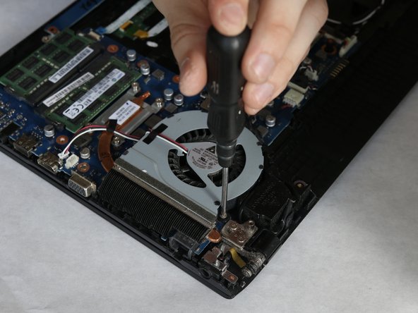

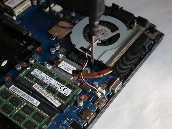

    • Remove the two 4 mm screws holding the fan in place.
    • Keep all screws gathered in the same place where they won’t get lost.

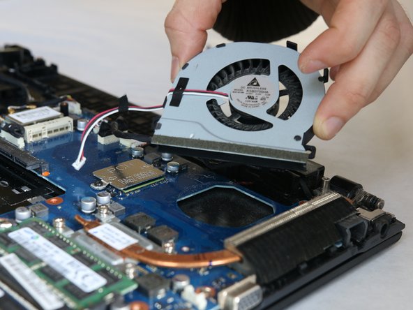

    • Unclip the white cable connecting the fan to the motherboard.
    • Carefully remove the fan from the laptop.
