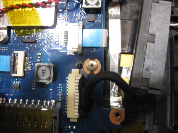

    • Once the cover is off, there are three screws holding the main PCB down.

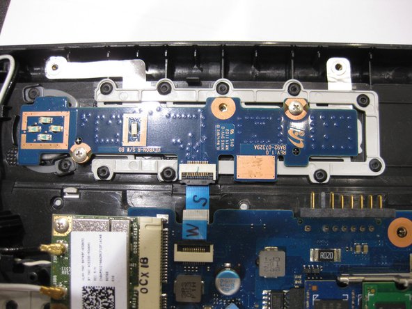

    • This shows the main PCB

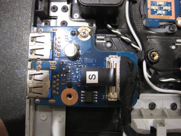

    • USB 3.0 Ports

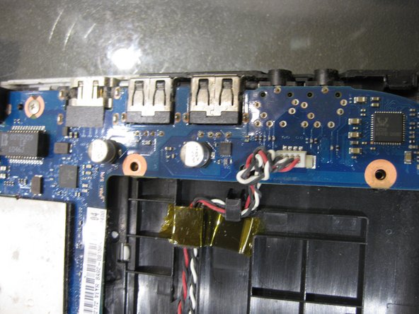

    • locations of the main PCB / WIFI card screws.

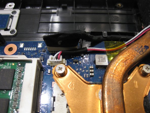

    • removing the Main PCB means detaching the cable marked M, W the big fat black cable at the top and the white connector at the right usb side.

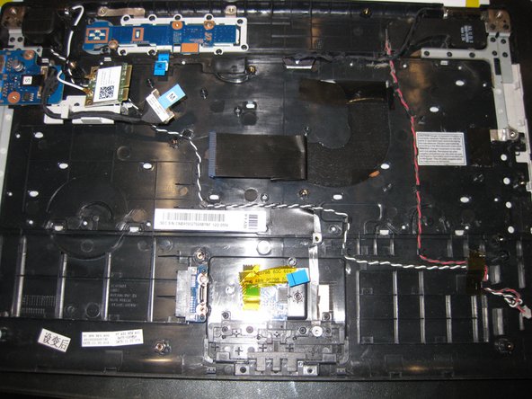

    • Here's the underside of the main PCB, all cables detached.
    • With the PCB removed this is all you have left.
