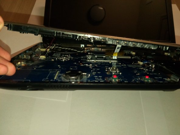

  10. Samsung NP-R540-JA09US Front Panel Replacement: crwdns2935265:011crwdnd2935265:01crwdnd2935265:01crwdne2935265:0
    • Remove the highlighted screws with a Phillips #0 Screwdriver.
  11. Samsung NP-R540-JA09US Front Panel Replacement: crwdns2935265:012crwdnd2935265:01crwdnd2935265:03crwdne2935265:0 Samsung NP-R540-JA09US Front Panel Replacement: crwdns2935265:012crwdnd2935265:02crwdnd2935265:03crwdne2935265:0 Samsung NP-R540-JA09US Front Panel Replacement: crwdns2935265:012crwdnd2935265:03crwdnd2935265:03crwdne2935265:0
    • Pry the front panel away from the base with an Opening Tool.

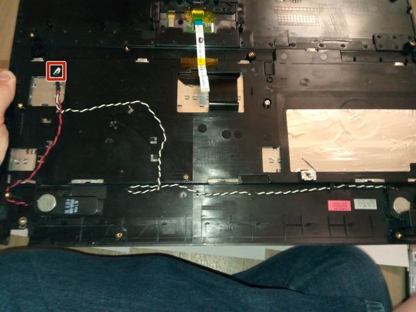

  12. Samsung NP-R540-JA09US Front Panel Replacement: crwdns2935265:013crwdnd2935265:01crwdnd2935265:02crwdne2935265:0 Samsung NP-R540-JA09US Front Panel Replacement: crwdns2935265:013crwdnd2935265:02crwdnd2935265:02crwdne2935265:0
    • Disconnect the speaker wire from the motherboard.
