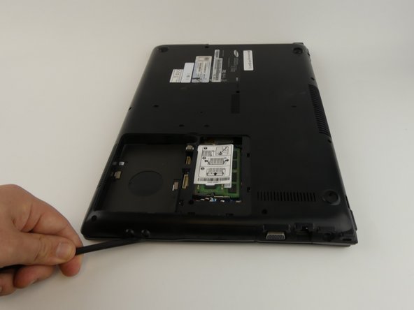

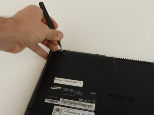

      • Remove the top two rubber stoppers using precision tweezers.

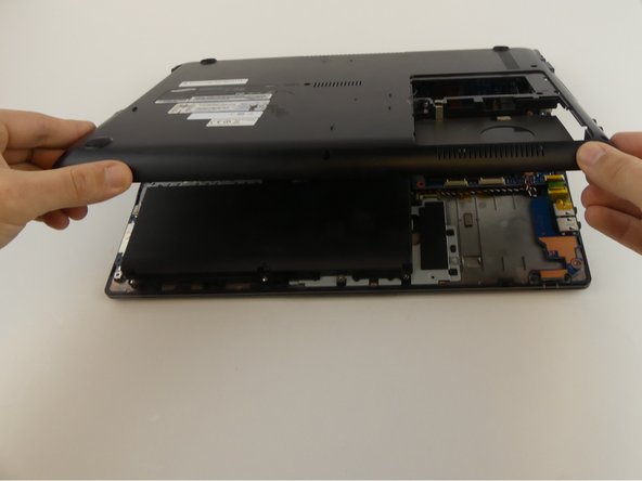

      • Unscrew nine 6 mm screws on the cover using a Phillips #000 screwdriver.
    4. Samsung NP-QX411L Screen Replacement: crwdns2935265:010crwdnd2935265:01crwdnd2935265:03crwdne2935265:0 Samsung NP-QX411L Screen Replacement: crwdns2935265:010crwdnd2935265:02crwdnd2935265:03crwdne2935265:0 Samsung NP-QX411L Screen Replacement: crwdns2935265:010crwdnd2935265:03crwdnd2935265:03crwdne2935265:0
      • Wedge the spudger under the cover to gently pry it up.

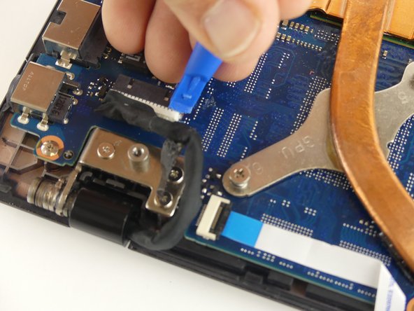

    5. Samsung NP-QX411L Screen Replacement: crwdns2935265:011crwdnd2935265:01crwdnd2935265:03crwdne2935265:0 Samsung NP-QX411L Screen Replacement: crwdns2935265:011crwdnd2935265:02crwdnd2935265:03crwdne2935265:0 Samsung NP-QX411L Screen Replacement: crwdns2935265:011crwdnd2935265:03crwdnd2935265:03crwdne2935265:0

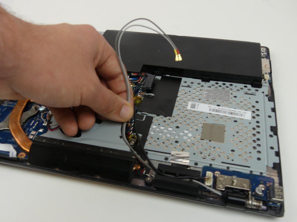

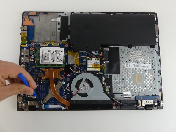

      • Disconnect the wire by carefully using the plastic opening tool to pry the connector away from the motherboard.

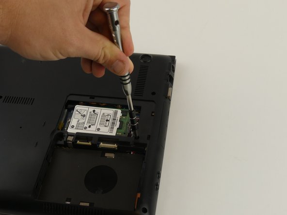

    6. Samsung NP-QX411L Screen Replacement: crwdns2935265:012crwdnd2935265:01crwdnd2935265:03crwdne2935265:0 Samsung NP-QX411L Screen Replacement: crwdns2935265:012crwdnd2935265:02crwdnd2935265:03crwdne2935265:0 Samsung NP-QX411L Screen Replacement: crwdns2935265:012crwdnd2935265:03crwdnd2935265:03crwdne2935265:0

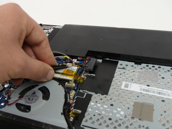

      • Use precision tweezers to pop the antenna wires off of the WiFi card.

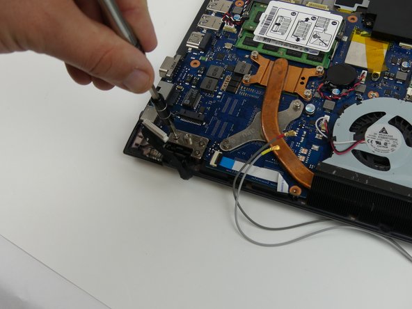

    7. Samsung NP-QX411L Screen Replacement: crwdns2935265:013crwdnd2935265:01crwdnd2935265:03crwdne2935265:0 Samsung NP-QX411L Screen Replacement: crwdns2935265:013crwdnd2935265:02crwdnd2935265:03crwdne2935265:0 Samsung NP-QX411L Screen Replacement: crwdns2935265:013crwdnd2935265:03crwdnd2935265:03crwdne2935265:0

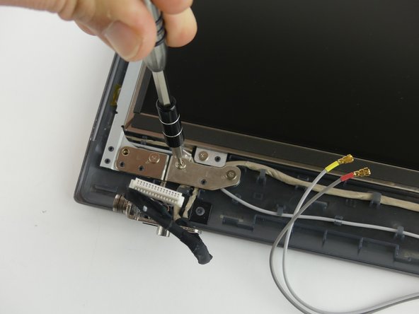

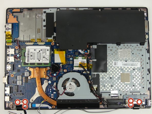

      • Open the laptop slightly.
      • Holding the laptop open, remove three 4 mm screws from each hinge (6 total) using a Phillips #000 screwdriver.

      • Hold hinges in place with your thumb and slide the laptop away from the screen.

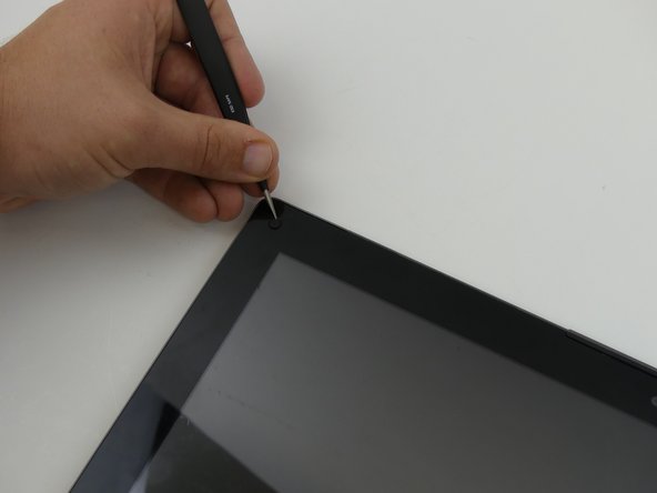

      • Remove the 4 rubber stoppers with the precision tweezers.
    10. Samsung NP-QX411L Screen Replacement: crwdns2935265:016crwdnd2935265:01crwdnd2935265:02crwdne2935265:0 Samsung NP-QX411L Screen Replacement: crwdns2935265:016crwdnd2935265:02crwdnd2935265:02crwdne2935265:0
      • Remove the four 4 mm screws with a Phillips #000 screwdriver.

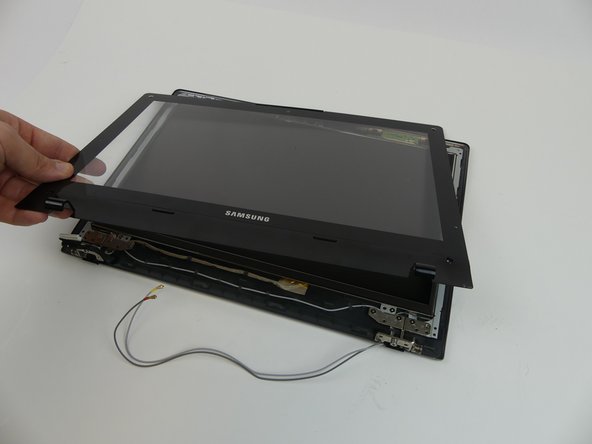

    11. Samsung NP-QX411L Screen Replacement: crwdns2935265:017crwdnd2935265:01crwdnd2935265:02crwdne2935265:0 Samsung NP-QX411L Screen Replacement: crwdns2935265:017crwdnd2935265:02crwdnd2935265:02crwdne2935265:0
      • The metal spudger could scratch the screen.
      • Wedge the metal spudger underneath the cover and run it along the edges. Gently pry the cover up.

      • Remove the three 4 mm screws on each hinge with a Phillips #000 screwdriver. There should be a total of 6 screws to remove.

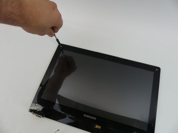

    1. Samsung NP-QX411L Screen Replacement, Screen: crwdns2935265:019crwdnd2935265:01crwdnd2935265:02crwdne2935265:0 Samsung NP-QX411L Screen Replacement, Screen: crwdns2935265:019crwdnd2935265:02crwdnd2935265:02crwdne2935265:0
      • Remove the four 4 mm screws using Phillips #000 screwdriver.
      • Remove metal brackets.
