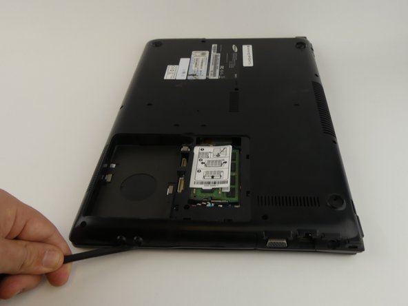

  4. Samsung NP-QX411L Battery Replacement: crwdns2935265:04crwdnd2935265:01crwdnd2935265:02crwdne2935265:0 Samsung NP-QX411L Battery Replacement: crwdns2935265:04crwdnd2935265:02crwdnd2935265:02crwdne2935265:0
    • Gently wedge the spudger under the square panel.
    • Run the spudger under the edges of the square panel to loosen it.
    • Remove the panel.

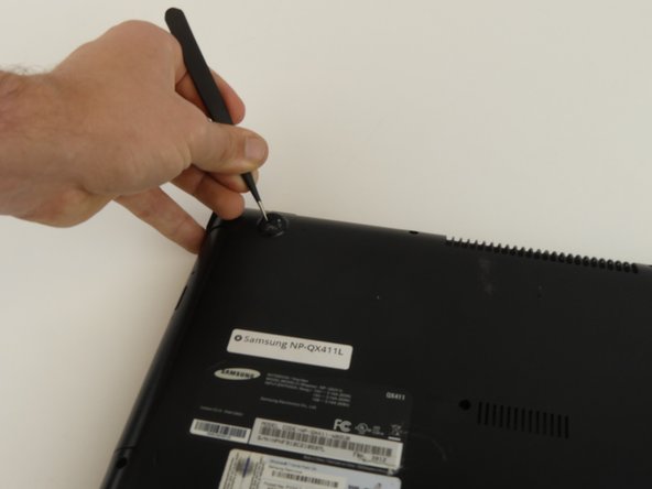

  8. Samsung NP-QX411L Battery Replacement: crwdns2935265:08crwdnd2935265:01crwdnd2935265:02crwdne2935265:0 Samsung NP-QX411L Battery Replacement: crwdns2935265:08crwdnd2935265:02crwdnd2935265:02crwdne2935265:0
    • Remove the top two rubber stoppers by grasping them with the precision tweezers and pulling up.

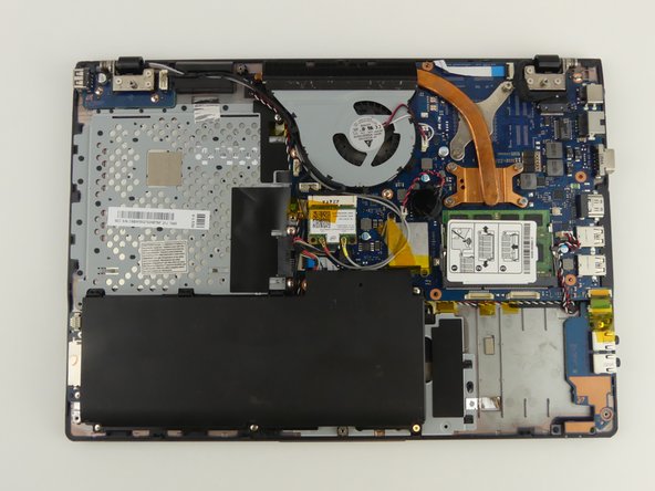

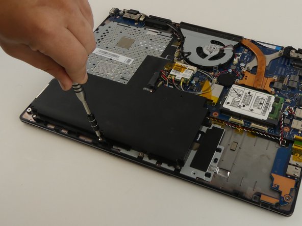

  11. Samsung NP-QX411L Battery Replacement: crwdns2935265:011crwdnd2935265:01crwdnd2935265:02crwdne2935265:0 Samsung NP-QX411L Battery Replacement: crwdns2935265:011crwdnd2935265:02crwdnd2935265:02crwdne2935265:0
    • Remove the four 3 mm screws using the Phillips #000 screwdriver.
  12. Samsung NP-QX411L Battery Replacement: crwdns2935265:012crwdnd2935265:01crwdnd2935265:01crwdne2935265:0
    • A wire is still connecting the battery to the motherboard.
    • Lift and slide the battery out from under the three plastic prongs.
  13. Samsung NP-QX411L Battery Replacement: crwdns2935265:013crwdnd2935265:01crwdnd2935265:01crwdne2935265:0
    • Grab the wires and gently pull them away from the motherboard.
