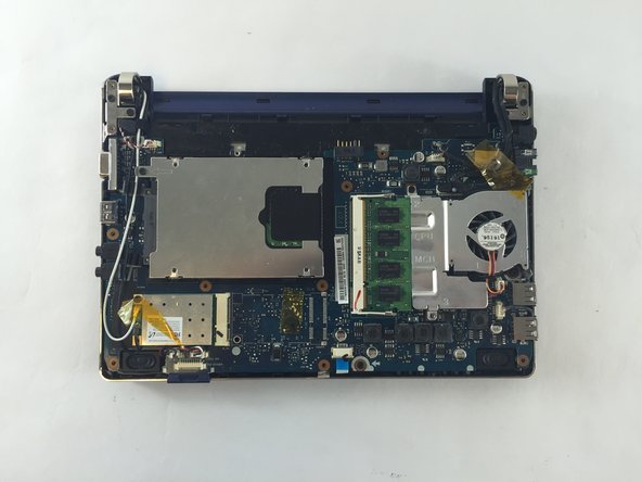

  7. Samsung NP-NC10-KA02US WLAN Card Replacement, WLAN Card: crwdns2935265:07crwdnd2935265:01crwdnd2935265:01crwdne2935265:0
    • Using a 3.93mm Phillips screwdriver remove the screw attaching the WLAN card.
  8. Samsung NP-NC10-KA02US WLAN Card Replacement: crwdns2935265:08crwdnd2935265:01crwdnd2935265:01crwdne2935265:0
    • Gently lift the WLAN card.

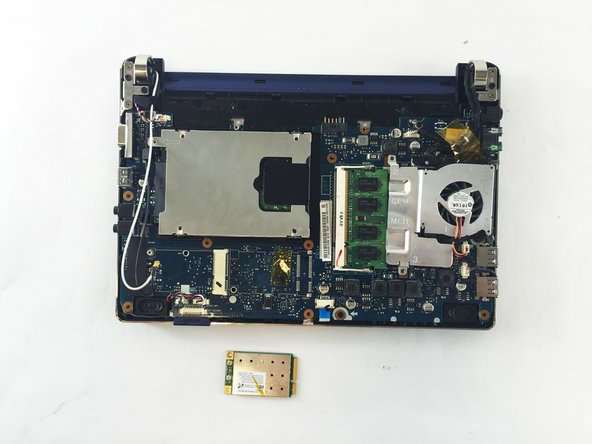

  9. Samsung NP-NC10-KA02US WLAN Card Replacement: crwdns2935265:09crwdnd2935265:01crwdnd2935265:02crwdne2935265:0 Samsung NP-NC10-KA02US WLAN Card Replacement: crwdns2935265:09crwdnd2935265:02crwdnd2935265:02crwdne2935265:0
    • Gently using a plastic opening tool, remove the two latches attached to the WLAN card in the netbook.
    • Your WLAN card is now removed.
