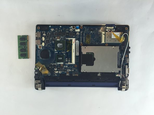

  10. Samsung NP-NC10-KA02US RAM Replacement, RAM: crwdns2935265:010crwdnd2935265:01crwdnd2935265:01crwdne2935265:0
    • After detaching the fan, you are now able to remove the RAM by extending the two side bars out
    • During this process, the computer needs to be shut off. Other components could be damaged and the computer would not be able to recognize the RAM properly.
  11. Samsung NP-NC10-KA02US RAM Replacement: crwdns2935265:011crwdnd2935265:01crwdnd2935265:02crwdne2935265:0 Samsung NP-NC10-KA02US RAM Replacement: crwdns2935265:011crwdnd2935265:02crwdnd2935265:02crwdne2935265:0
    • With the bars extended, you are now able to slide the RAM off the base.

There is a small lid with one screw for RAM replacement. No need to remove all the bottom part.
