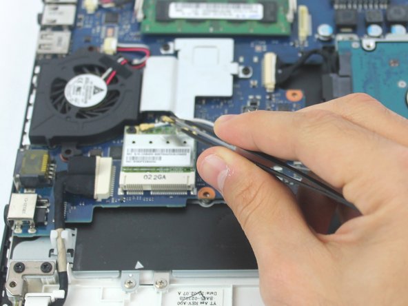

    • Locate the wireless card.
  7. Samsung NP-N210-JA02US Wireless Card Replacement: crwdns2935265:07crwdnd2935265:01crwdnd2935265:01crwdne2935265:0
    • Remove the 3.5 mm Philips #1 screw.
  8. Samsung NP-N210-JA02US Wireless Card Replacement: crwdns2935265:08crwdnd2935265:01crwdnd2935265:02crwdne2935265:0 Samsung NP-N210-JA02US Wireless Card Replacement: crwdns2935265:08crwdnd2935265:02crwdnd2935265:02crwdne2935265:0
    • Carefully with tweezers, lift both connectors to disconnect them from the wireless card.
  9. Samsung NP-N210-JA02US Wireless Card Replacement: crwdns2935265:09crwdnd2935265:01crwdnd2935265:01crwdne2935265:0
    • Gently remove the wireless card from its socket.
