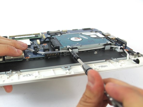

  7. Samsung NP-N210-JA02US Hard Drive Replacement: crwdns2935265:07crwdnd2935265:01crwdnd2935265:02crwdne2935265:0 Samsung NP-N210-JA02US Hard Drive Replacement: crwdns2935265:07crwdnd2935265:02crwdnd2935265:02crwdne2935265:0
    • Remove the four black 3.5 mm Philips #1 screws on the (side) of the hard drive.

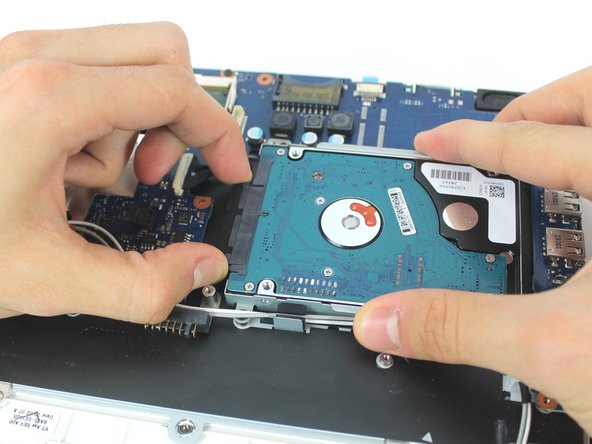

  8. Samsung NP-N210-JA02US Hard Drive Replacement: crwdns2935265:08crwdnd2935265:01crwdnd2935265:01crwdne2935265:0
    • Gently lift the hard drive from its mounting bracket.
