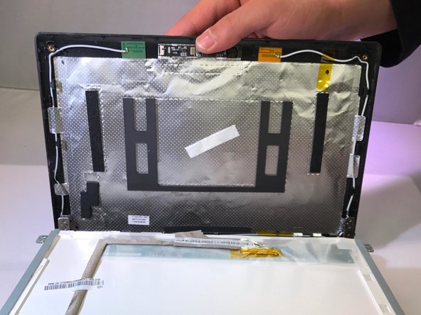

  3. Samsung NP-N145-JP02US Screen Replacement: crwdns2935265:03crwdnd2935265:01crwdnd2935265:01crwdne2935265:0
    • Use a blue prying tool to pry the screen frame off.
    • Unscrew the four 6.5mm screws that are securing the screen using Phillips J0 screwdriver head.
  4. Samsung NP-N145-JP02US Screen Replacement: crwdns2935265:04crwdnd2935265:01crwdnd2935265:03crwdne2935265:0 Samsung NP-N145-JP02US Screen Replacement: crwdns2935265:04crwdnd2935265:02crwdnd2935265:03crwdne2935265:0 Samsung NP-N145-JP02US Screen Replacement: crwdns2935265:04crwdnd2935265:03crwdnd2935265:03crwdne2935265:0
    • Using your fingertips, gently pull screen to pop it out of the frame.
