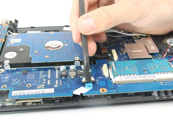

    • Use the spudger to remove the red and black cable located above the speaker from it's connector.
    • Also using the spudger, remove the small ribbon cable located a the bottom of the motherboard, towards the middle.
    • Fold the motherboard back, using the computer hinge as the axis of rotation. The motherboard will still be attached to the case by a few wires.
