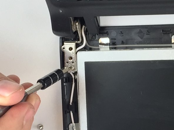

  3. Samsung NP-N102S-B05PH Display Replacement: crwdns2935265:03crwdnd2935265:01crwdnd2935265:03crwdne2935265:0 Samsung NP-N102S-B05PH Display Replacement: crwdns2935265:03crwdnd2935265:02crwdnd2935265:03crwdne2935265:0 Samsung NP-N102S-B05PH Display Replacement: crwdns2935265:03crwdnd2935265:03crwdnd2935265:03crwdne2935265:0
    • Unscrew each of the four 6.5mm Phillips #0 screws securing the screen to the case.

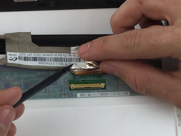

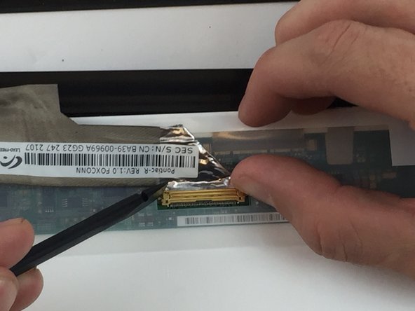

  4. Samsung NP-N102S-B05PH Display Replacement: crwdns2935265:04crwdnd2935265:01crwdnd2935265:03crwdne2935265:0 Samsung NP-N102S-B05PH Display Replacement: crwdns2935265:04crwdnd2935265:02crwdnd2935265:03crwdne2935265:0 Samsung NP-N102S-B05PH Display Replacement: crwdns2935265:04crwdnd2935265:03crwdnd2935265:03crwdne2935265:0
    • Using the black spudger tool and your fingertip, gently push on the ends of the ribbon cable to pop it out of the socket.
  5. Samsung NP-N102S-B05PH Display Replacement: crwdns2935265:05crwdnd2935265:01crwdnd2935265:01crwdne2935265:0
    • The screen is can now be lifted away from the laptop.
