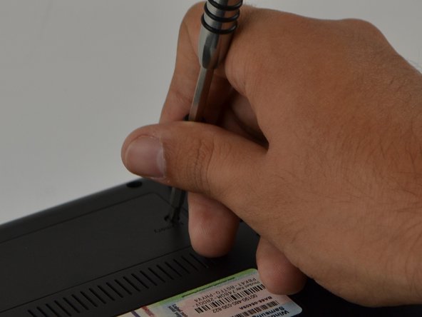

    1. Samsung NP-130-JA01US RAM Replacement, RAM: crwdns2935265:04crwdnd2935265:01crwdnd2935265:02crwdne2935265:0 Samsung NP-130-JA01US RAM Replacement, RAM: crwdns2935265:04crwdnd2935265:02crwdnd2935265:02crwdne2935265:0
      • Locate the "Memory" panel on the bottom right corner.
      • Use the Phillips 01 screwdriver to remove the screw.
      • The screw is a Phillips 1 (PH 1) with a length of 60 millimeters (mm)
    2. Samsung NP-130-JA01US RAM Replacement: crwdns2935265:05crwdnd2935265:01crwdnd2935265:01crwdne2935265:0
      • With your hand, lift panel and remove it.

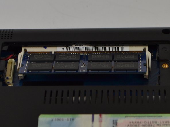

    3. Samsung NP-130-JA01US RAM Replacement: crwdns2935265:06crwdnd2935265:01crwdnd2935265:02crwdne2935265:0 Samsung NP-130-JA01US RAM Replacement: crwdns2935265:06crwdnd2935265:02crwdnd2935265:02crwdne2935265:0
      • Slide metal prongs (marked in red squares) away from each other with your fingers.
      • The RAM chip will automatically lift up at an angle for easy ejection.

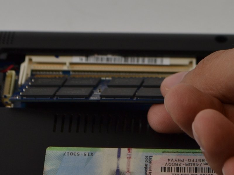

    4. Samsung NP-130-JA01US RAM Replacement: crwdns2935265:07crwdnd2935265:01crwdnd2935265:01crwdne2935265:0
      • With your hands, carefully slide the RAM chip out to remove.
      • The RAM chip is delicate, do not force it when removing it.
