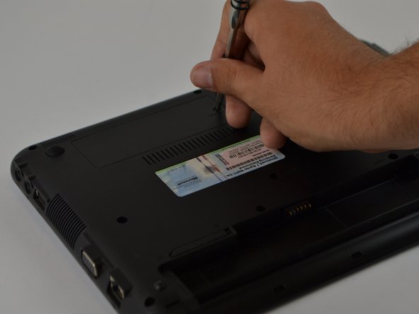

    • Using a Phillips 1 screwdriver carefully remove all 12 screws of the back cover.
    • The screws are Phillips 1 (PH 1) with a length of 60 millimeters (mm)
    • Do not force the screwdriver as you might damage the screws.

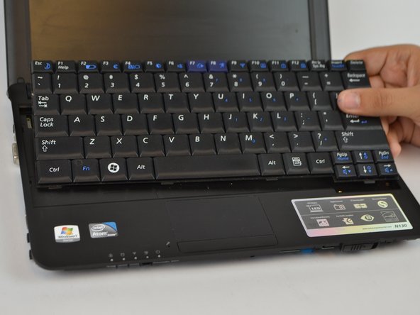

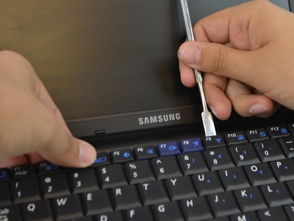

    • Flip the computer and open the front cover so that the screen is looking at you.
    • Using a Metal Spudger and your dominant hand, carefully separate the keyboard from the computer frame.
    • Do not force the keyboard out, it should come out easily with the help of the Metal Spudger

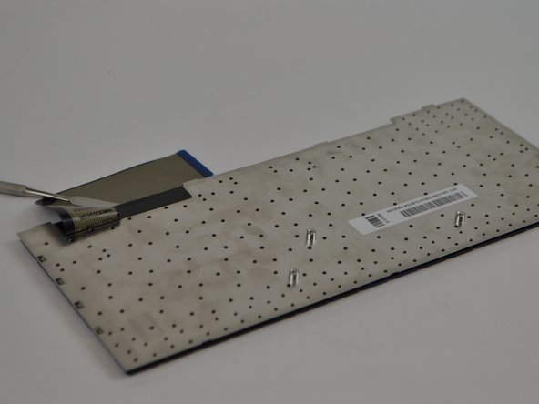

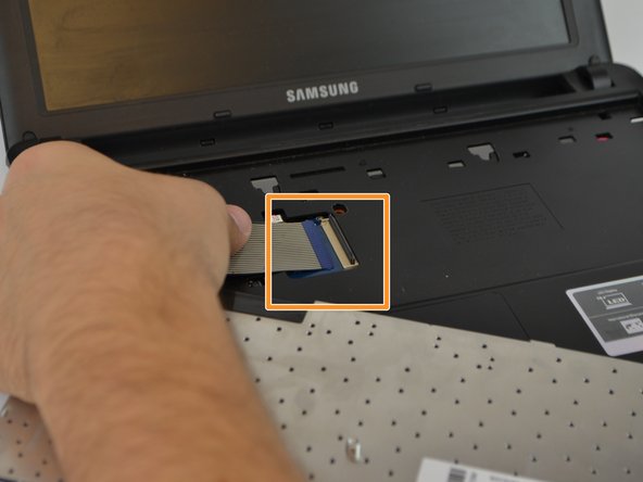

    • Flip the keyboard over.
    • Notice the lock mechanism (marked in red) that holds the cables to the computer.
    • With your fingers, flip the mechanism over before pulling the cables out.
    • Second picture shows the unlocked position.
    • Carefully pull the cables out of the computer.
