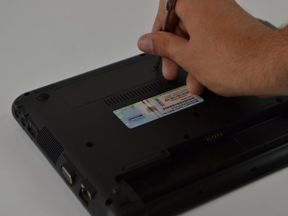

    • Turn off the computer.
    • Disconnect the charger cable from the computer.
    • Failure to disconnect the charger cable from the computer could result in an electric shock.
    • Flip the computer over so the underside is facing up.
  2. Samsung NP-130-JA01US Hard Drive Replacement: crwdns2935265:02crwdnd2935265:01crwdnd2935265:02crwdne2935265:0 Samsung NP-130-JA01US Hard Drive Replacement: crwdns2935265:02crwdnd2935265:02crwdnd2935265:02crwdne2935265:0
    • Slide the left and right slider buttons fully away from each other.
  3. Samsung NP-130-JA01US Hard Drive Replacement: crwdns2935265:03crwdnd2935265:01crwdnd2935265:01crwdne2935265:0
    • Pull the battery out of the computer.
  4. Samsung NP-130-JA01US Hard Drive Replacement, Hard Drive: crwdns2935265:04crwdnd2935265:01crwdnd2935265:02crwdne2935265:0 Samsung NP-130-JA01US Hard Drive Replacement, Hard Drive: crwdns2935265:04crwdnd2935265:02crwdnd2935265:02crwdne2935265:0
    • Using a Philips 1 screwdriver carefully remove all 12 screws of the back cover.
    • The screws are Phillips 1 (PH 1) with a length of 60 millimeters (mm)
    • Do not force the screwdriver as you might damage the screws.

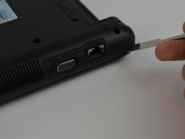

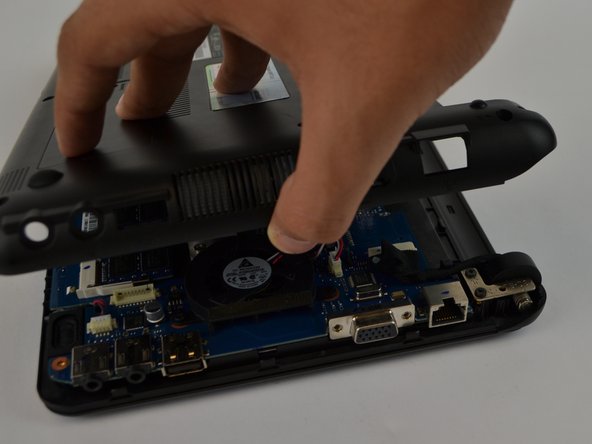

  5. Samsung NP-130-JA01US Hard Drive Replacement: crwdns2935265:05crwdnd2935265:01crwdnd2935265:03crwdne2935265:0 Samsung NP-130-JA01US Hard Drive Replacement: crwdns2935265:05crwdnd2935265:02crwdnd2935265:03crwdne2935265:0 Samsung NP-130-JA01US Hard Drive Replacement: crwdns2935265:05crwdnd2935265:03crwdnd2935265:03crwdne2935265:0
    • With the plastic opening tool, carefully separate the back cover from the computer frame.
    • Starting at one of the corners of the computer, work your way around the edge until you reach the other corner.
    • Do not attempt to pry it open, putting too much force into one location might damage the computer.
    • As you go around the sides of the computer, free the inside latches with the plastic opening tool.
    • Once you have an opening, carefully use your hands to separate the back cover.

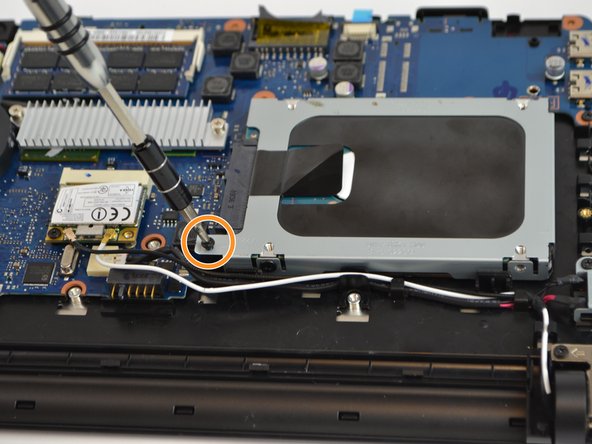

  6. Samsung NP-130-JA01US Hard Drive Replacement: crwdns2935265:06crwdnd2935265:01crwdnd2935265:02crwdne2935265:0 Samsung NP-130-JA01US Hard Drive Replacement: crwdns2935265:06crwdnd2935265:02crwdnd2935265:02crwdne2935265:0
    • Locate Hard Drive (red square)
    • Using a Phillips 1 screw driver, remove the screw marked in the red circle.
    • The screw is a Phillips 1 (PH 1) with a length of 40 millimeters (mm)
    • Unscrew carefully to prevent losing or breaking pieces.

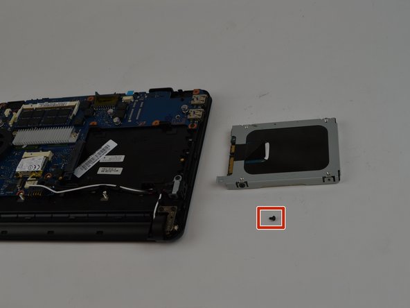

  7. Samsung NP-130-JA01US Hard Drive Replacement: crwdns2935265:07crwdnd2935265:01crwdnd2935265:02crwdne2935265:0 Samsung NP-130-JA01US Hard Drive Replacement: crwdns2935265:07crwdnd2935265:02crwdnd2935265:02crwdne2935265:0
    • Gently remove the hard drive.
