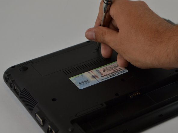

    • Using a Phillips 1 screwdriver, carefully remove all 12 screws of the back cover.
    • The screws are Phillips 1 (PH 1) with a length of 60 millimeters (mm)
    • Do not force the screwdriver as you might damage the screws.

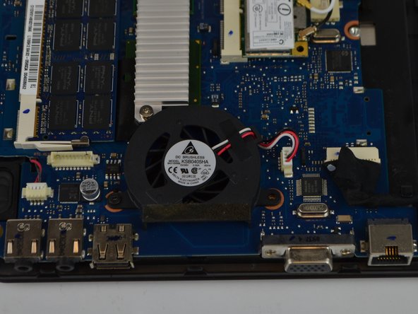

    • Locate the fan (marked in a red square).

    • Using a Phillips 1 screwdriver, remove the screw marked in a red circle.
    • The screw is a Phillips 1 (PH 1) with a length of 40 millimeters (mm)
    • Do not use too much force on the screw driver, you might damage the screw.
    • Using your hands, carefully unplug the cords marked in a green square.

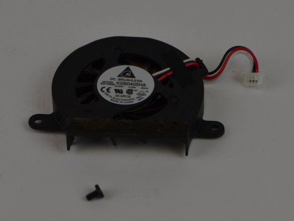

    • Carefully remove the fan.
