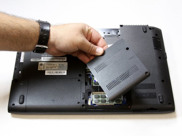

    • Remove the two 9mm Phillips head screws on the back plate labeled "memory."
    • Remove the back plate labeled "memory."
    • Disconnect the two gray connectors.

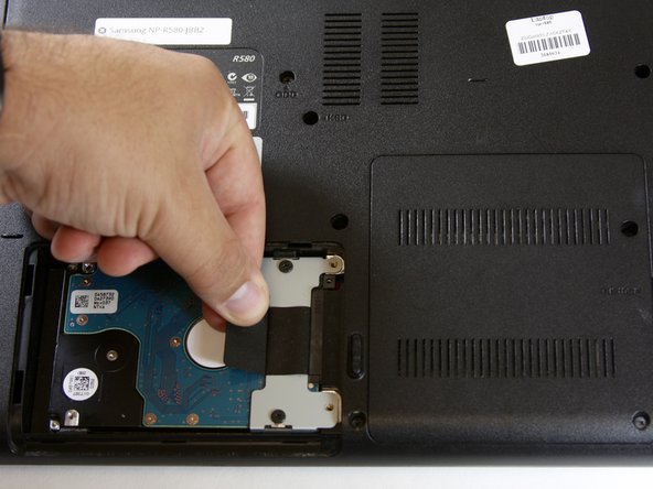

    • Remove the two 5mm Phillips head screws on the back plate labeled "HDD."
    • Remove the back plate to the hard drive by pulling downward and lifting away.
    • Pull laterally to the left on the black tab until it releases its connection and is able to be lifted free.

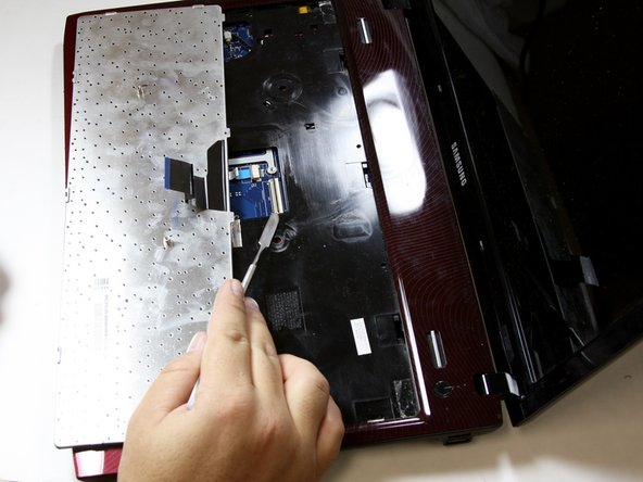

    • Open the computer and locate the three keyboard release tabs. Once located, use a flat metal device to pry the tabs open.

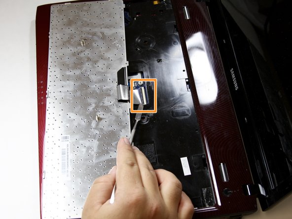

    • Lift the keyboard away to discover its ribbon connector beneath.
    • Lift the black portion of the connector to release the ribbon and set the keyboard aside.

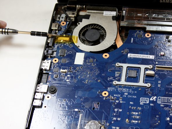

  10. Samsung NP R580 JBB2 Cooling Fan Replacement: crwdns2935265:010crwdnd2935265:01crwdnd2935265:02crwdne2935265:0 Samsung NP R580 JBB2 Cooling Fan Replacement: crwdns2935265:010crwdnd2935265:02crwdnd2935265:02crwdne2935265:0
    • Disconnect the white USB drive plug by pulling outwards using a nylon spudger.
    • Disconnect the blue DVD player ribbon tab by pulling the blue tab outwards laterally away from the mother board using a nylon spudger.
    • Disconnect the screen connection wire by pulling it towards the screen using a nylon spudger.
  11. Samsung NP R580 JBB2 Cooling Fan Replacement: crwdns2935265:011crwdnd2935265:01crwdnd2935265:01crwdne2935265:0
    • Remove the three 5mm Phillips head screws on the motherboard and the one 5mm Phillips head screw on the fan.
    • All screws have white arrows pointing towards them.

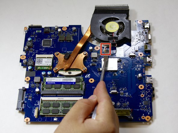

  12. Samsung NP R580 JBB2 Cooling Fan Replacement: crwdns2935265:012crwdnd2935265:01crwdnd2935265:02crwdne2935265:0 Samsung NP R580 JBB2 Cooling Fan Replacement: crwdns2935265:012crwdnd2935265:02crwdnd2935265:02crwdne2935265:0
    • Work the motherboard out of the housing by lifting upwards.
    • Disconnect the fan's cord from the motherboard by pulling upwards on it.

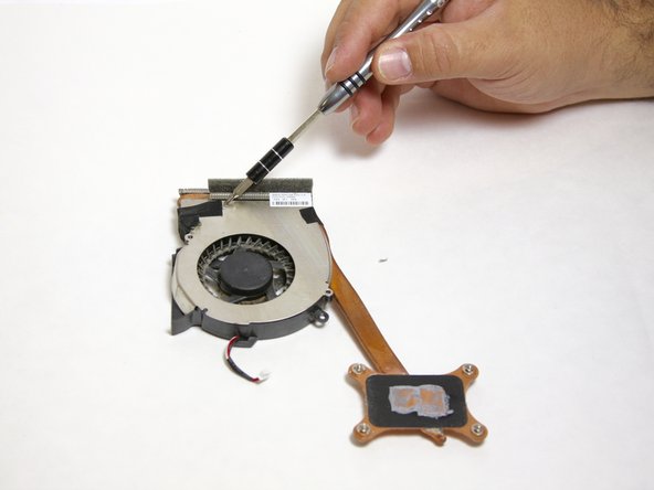

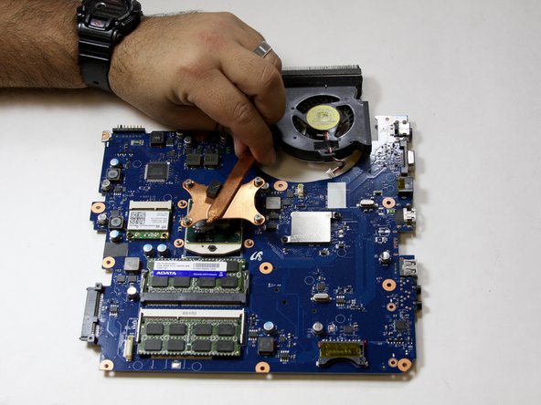

  13. Samsung NP R580 JBB2 Cooling Fan Replacement: crwdns2935265:013crwdnd2935265:01crwdnd2935265:03crwdne2935265:0 Samsung NP R580 JBB2 Cooling Fan Replacement: crwdns2935265:013crwdnd2935265:02crwdnd2935265:03crwdne2935265:0 Samsung NP R580 JBB2 Cooling Fan Replacement: crwdns2935265:013crwdnd2935265:03crwdnd2935265:03crwdne2935265:0
    • Loosen the four self-retaining screws located on the copper cooling bar.
    • Lift and remove the fan.

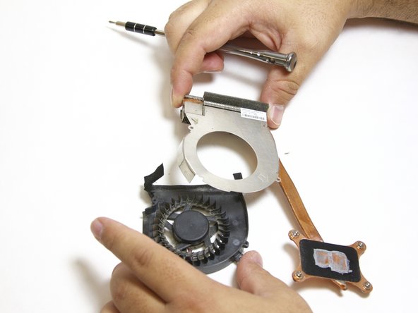

  14. Samsung NP R580 JBB2 Cooling Fan Replacement: crwdns2935265:014crwdnd2935265:01crwdnd2935265:03crwdne2935265:0 Samsung NP R580 JBB2 Cooling Fan Replacement: crwdns2935265:014crwdnd2935265:02crwdnd2935265:03crwdne2935265:0 Samsung NP R580 JBB2 Cooling Fan Replacement: crwdns2935265:014crwdnd2935265:03crwdnd2935265:03crwdne2935265:0
    • Remove the three 3mm Phillips screws on the fan housing.
    • Peel the tape off of the fan housing.
    • Remove the fan from the cooling hardware.
