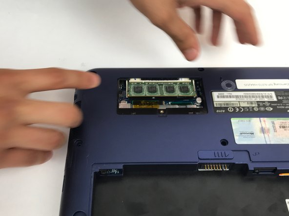

  2. Samsung NP N310 HAA2US RAM Replacement, RAM: crwdns2935265:02crwdnd2935265:01crwdnd2935265:03crwdne2935265:0 Samsung NP N310 HAA2US RAM Replacement, RAM: crwdns2935265:02crwdnd2935265:02crwdnd2935265:03crwdne2935265:0 Samsung NP N310 HAA2US RAM Replacement, RAM: crwdns2935265:02crwdnd2935265:03crwdnd2935265:03crwdne2935265:0
    • Locate and unscrew the 5mm screw on the small panel on the back that has 'memory' written on it.
    • Pull off the memory panel.
  3. Samsung NP N310 HAA2US RAM Replacement: crwdns2935265:03crwdnd2935265:01crwdnd2935265:03crwdne2935265:0 Samsung NP N310 HAA2US RAM Replacement: crwdns2935265:03crwdnd2935265:02crwdnd2935265:03crwdne2935265:0 Samsung NP N310 HAA2US RAM Replacement: crwdns2935265:03crwdnd2935265:03crwdnd2935265:03crwdne2935265:0
    • Pull the 2 latches holding the RAM in, away from the RAM stick, and the RAM will pop up.
    • Pull the RAM out of the slot, only touching the edges of the RAM stick
