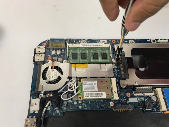

  4. Samsung NP N310 HAA2US Cooling Fan Replacement, Cooling Fan: crwdns2935265:04crwdnd2935265:01crwdnd2935265:02crwdne2935265:0 Samsung NP N310 HAA2US Cooling Fan Replacement, Cooling Fan: crwdns2935265:04crwdnd2935265:02crwdnd2935265:02crwdne2935265:0
    • Remove the 3 Phillips 4.5mm silver screws on the fan. Use a size 1 Phillips screwdriver
    • Remove the 1 Phillips 8mm black screw on the fan. Use a size 1 Phillips screwdriver.
  5. Samsung NP N310 HAA2US Cooling Fan Replacement: crwdns2935265:05crwdnd2935265:01crwdnd2935265:02crwdne2935265:0 Samsung NP N310 HAA2US Cooling Fan Replacement: crwdns2935265:05crwdnd2935265:02crwdnd2935265:02crwdne2935265:0

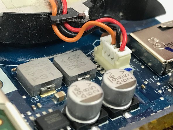

    • Lift the fan up, and remove the yellow tape.
    • Unplug the fan cable.
