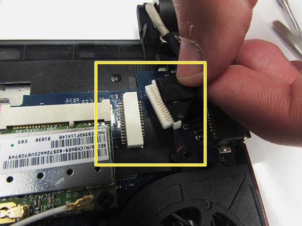

    • Unclip the two white wires connected to the computer chip on the motherboard by pulling the white wire toward you.
    • Make sure you don't damage the terminals for the white wires on the computer chip by pulling to hard on them.
    • Remove the yellow tape securing the black cable that is connected to the motherboard.
    • Be gentle when removing the yellow tape. It is very thin and can ripe easily.
    • Once you have removed the yellow tape, unplug the black cable from its connection on the motherboard.

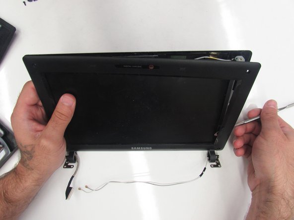

    • Slowly remove the screen case from the rest of the laptop by pulling the screen case out of the hinge sockets.
  10. Samsung N150 Plus Screen Replacement: crwdns2935265:010crwdnd2935265:01crwdnd2935265:01crwdne2935265:0
    • Use a Phillips #00 to unscrew the four 5mm screws located at the top and bottom corners of the screen bezel.
  11. Samsung N150 Plus Screen Replacement: crwdns2935265:011crwdnd2935265:01crwdnd2935265:02crwdne2935265:0 Samsung N150 Plus Screen Replacement: crwdns2935265:011crwdnd2935265:02crwdnd2935265:02crwdne2935265:0
    • Use the spudger or plastic opening tools to wedge it in-between the screen bezel and bottom of the screen case.
    • Apply pressure upwards to pop the screen bezel open.

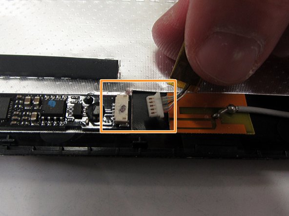

    • Lift the screen out of the bottom screen case and locate the white plug connected to the bottom case.
    • Pull the wires away from you to unplug the wires from their connection on the bottom screen case.
    • Be gentle when pulling on the wires, so that you don't disconnect them from their plug.

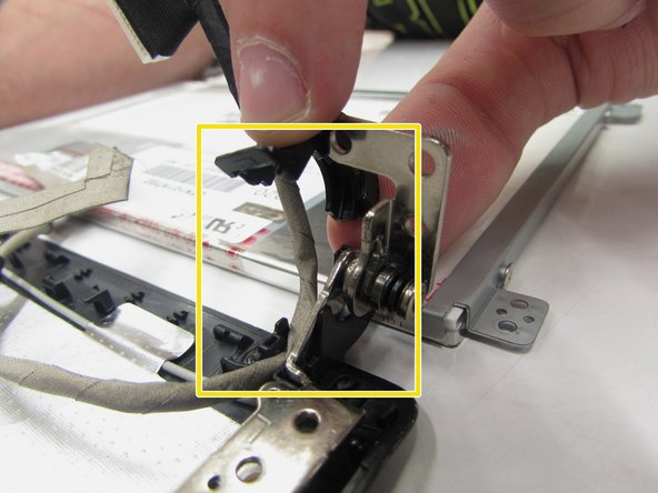

    • Unclip half of the black case hinge to release the wire from its casing
  14. Samsung N150 Plus Screen Replacement: crwdns2935265:014crwdnd2935265:01crwdnd2935265:01crwdne2935265:0
    • The screen is fully disconnected from the screen bezel and can now be removed.
