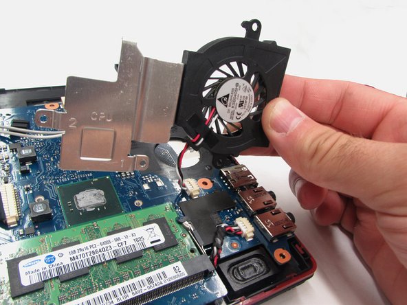

    • Use the phillips #00 screwdriver, to unscrew the two 5mm mounting screws labeled 1 & 2 on the right and left hand side of the metal casing labeled CPU.

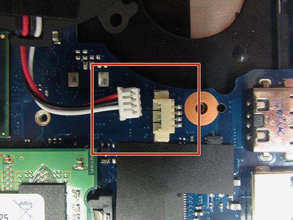

    • Unplug the the wires from the white connector attached to the motherboard, by pulling the wires toward you.
    • When pulling on the wires make sure not to detach the wires from the white plug that connects to the motherboard.
  9. Samsung N150 Plus Fan Replacement: crwdns2935265:09crwdnd2935265:01crwdnd2935265:01crwdne2935265:0
    • Remove the metal casing with the fan attached from the motherboard.

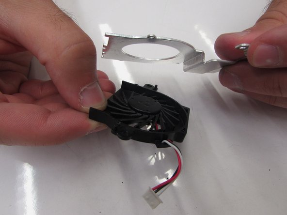

    • Use the Phillips #000 screwdriver, to unscrew the three 4mm screws.
  11. Samsung N150 Plus Fan Replacement: crwdns2935265:011crwdnd2935265:01crwdnd2935265:02crwdne2935265:0 Samsung N150 Plus Fan Replacement: crwdns2935265:011crwdnd2935265:02crwdnd2935265:02crwdne2935265:0
    • Remove the fan from the metal CPU housing.
