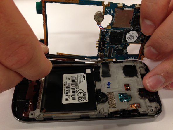

    • DO NOT remove the motherboard completely. One more clip on the motherboard's backside needs to be removed.
    • Carefully tilt the motherboard up from the back of the phone.
    • Use tweezers to unclip the black connector.
